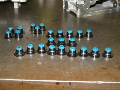

My latest engine failure was caused by a broken valve going through the motor. When we tore it apart this is what the seals look like. You can see the deep grooves in the seals. We're running Comp cams and springs. The springs do have some runout but Comp states its's expected with beehive (conical) type springs. The seals were stock with about 4 hours of run time.
Anyone see anything like this? Any known issues with Comp springs?

Ferrea valves, Comp cams with custom grind (Comp did the grind), Comp beehive valve springs, I'm not sure what brand the seals are but they are softer than the OEM ones.

Upon inspection we found the after market seals are much softer that OEM's. It's hard to get an actual reading based on the flange thickness but my guess is a difference of at least 20 RC points based on the stylus penetration. We compared the springs to OEM and a competitor's brand for hardness, concentricity, and the perpendicularity of the faces.
OEM's have the best geometry but are slightly softer. Our Comp springs were definitely better the brand X.

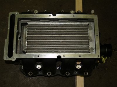

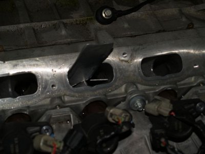

Let me back up a bit. We're running a Saleen S/C. The heat exchanger sits in the blower case and just rests on a ledge. There is a stamped aluminum bracket welded to the outside of the H/E which creates a flange that sits on the ledge. The two coolant ports are the only thing that actually secure the H/E in the case.
Apparently the H/E was bouncing inside the case and the backside of the welded bracket broke off and went into the motor. We removed the visible debris and ran a leak down test which showed loss of pressure in one particular piston. Dyno test showed same power curve and subsequent leak down showed improvement. Our assumption was some aluminum debris was working it's way out of the cylinder. All else looked normal so we went back to the track (road coarse). Within 40 minutes we had a broken valve. The stem of the valve has aluminum galled on it so we figured the H/E particles may have caused the valve to stick.
Once we tore it down we found the guides with these worn grooves. The H/E has been repaired and at this point we're trying to understand how the seals got that way. We are working under the assumption there was another cause.
