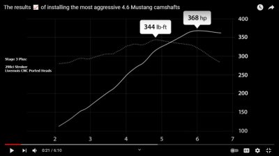

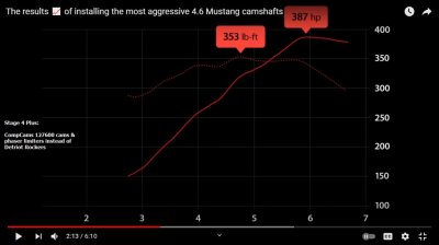

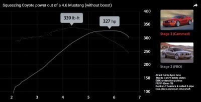

Four Eyes has a Livernois built 298ci stroker and since he's also planning to add forced induction, he kept the compression ratio in the mid 9s rather than the ~11:1 compression that would have been the norm for a NA stroker. Hence his engine "only" made 387rwhp despite having full bolt ons plus Livernois CNC heads, 127600 cams, and the Ford Performance intake manifold. Otherwise he could have been at ~410rwhp.Four Eyes Stage 2.jpgFour Eyes Stage 3.jpgFour Eyes Stage 4.jpg Four Eyes Stage 5.jpg
