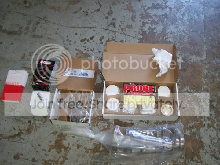

Probe Industries 5.1L stroker
Forged, pistons, H beam rods, and crank.
All ARP and ARP 2000 hardware

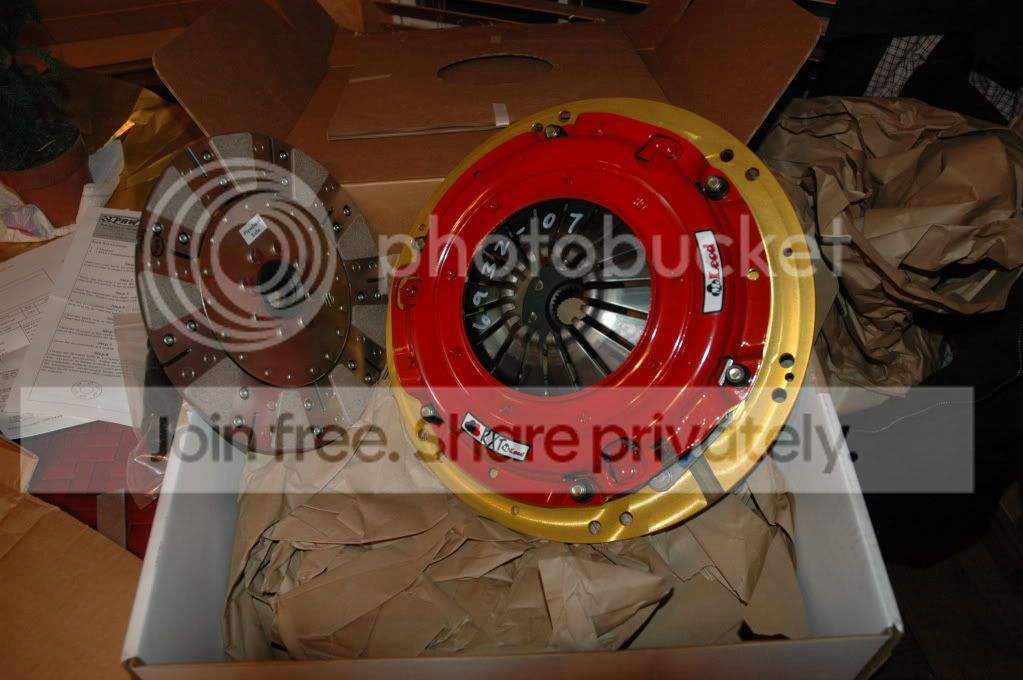

Mcleod RXT twin disk

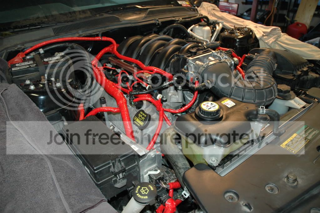

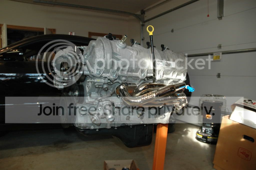

This is the engine once it was all put back together longblock. The reason I went with shorty headers is this is going to be a turbo build, not SC.
RXT

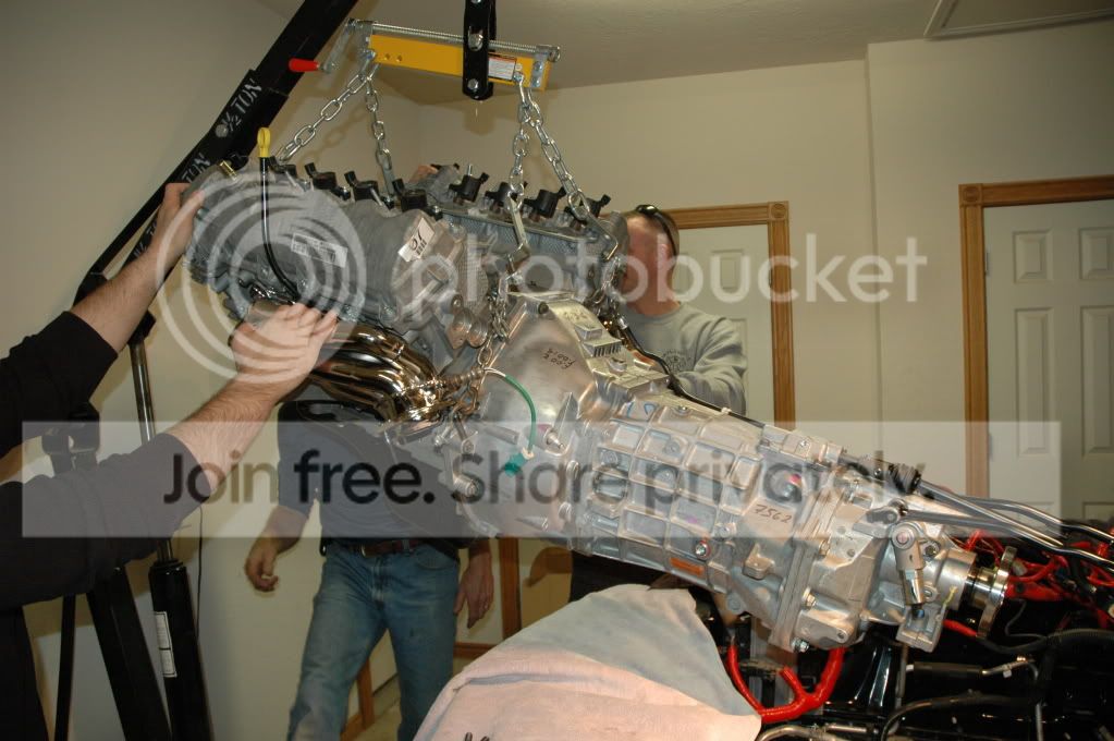

5.1 and TR-6060 going in
Everything is in and it is actually running in this picture. The car is going to run in this conficuration for about 1k miles to break the engine in a bit before getting boosted.

I like the understated clean factory look. You will love the 6060. How does Probe spec out the stroker? I'm guessing 3.75 crank with 5.85 rods and a custom compression height on the pistons.
Bruce mine was a 3.75 stroke with 6" rod. compression was 8.5:1

Awesum! Is that the stock 4.6 block just bored out? Sorry im just looking to build a stoker myself and looking at different options
Yes to stock block; but no it wasn't bored at all. The rods are longer and the pistons are both shorter and dished, which gives the cylinder a larger chamber area. I did have the block machined and cleaned up, but the cylinder bore is still the same.
shoulda kept facory manifolds
I wasn't looking for any power gains from the shortys. I just didn't want that rusty log sitting on the side of my block. Is there a specific reason I should have kept them? They are still on the shelf here in my garage if need be.
I am using the Probe SRS forged pistons
Ford 5.1L (3V) Dish Top -12.7cc - SRS Piston Set
Part Number: 14780
1.048" Compression Height
3.750" Stroke
6.000" Rod Length
0.927" Pin OD
1.5 mm 1.5 mm 3.0 mm Rings
Mated with probes dominator rotating assembly (with H instead of their I beam rods)
http://www.probeindustries.com/Probe_Industries_Engine_Kits_s/301.htm

anything flows better than the stock headers..... Only benefit the stockers have over the shorties you have is heat resistance.
I can get behind that; I just never liked the fuzzy log look so I dumped em while the motor was out. I can honestly say I have no idea why anyone would ever willingly do headers while the motor is still in the car. It's almost easier just to pull the motor. Undo the wiring harness and lines, unbolt a full things and yank that sucker out. (Disclaimer: it really isn't that easy kids, don't try this unless you have a lot of money to fix what you broke or know what your doing'ish)

I honestly think he would see gains throughout just not peak gain like he would with LTs. He got the same idea as me, I'm gonna put on some equal length shorties when the motor is out.

Since this has turned somewhat into a shortie header thread this is my take. Make sure you get the BBK x-pipe catted or not to take full advantage of the set up. I went that route on my '07 and I'm not going to say it was as good as long tubes however there was a significant gain in HP. Engine bay looks nice also.:thumb:

Stockers retain the heat better...all those are gonna do us heat the bay up more... Coat the stickers if you don't like the rust look haha
