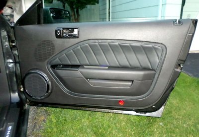

No! You cannot remove all the factory adhesive. It cannot be done! The factory adhesive is some kind of epoxy that glues the felt panel to the door panel. This adhesive actually heats up when curing and melts the felt into the plastic! Trust me I tried for months, any and every tool on the market and chemical imaginable to remove this adhesive. I eventually just bought the Coverlay and put it on the panel.
This is after months of trying to clean this panel so it would look like just a standard panel.
I didn't try to strip the door panels down to bare plastic; that looked like an impossible task. I just used a fine wire brush, acetone, and a towel to get the old deteriorated foam completely off.

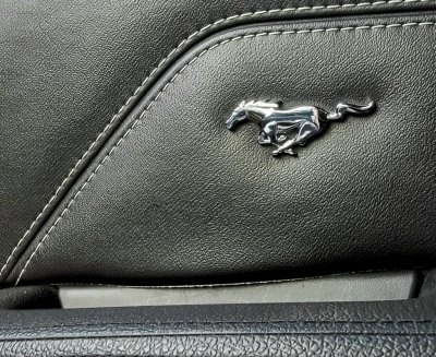

I purchased the "Buckskin" black vinyl to keep the original Bullitt door panel look. I cleaned all the old panel foam & felt off & wire wheeled the glue off. I lightly sanded the panel with 80 grit sand paper by hand & cleaned it up with Acetone. i made a pattern outta painters paper off the old vinyl. I used 1/4" black dense foam. I cut the new vinyl out glued it to the foam before I cut it out. I used SprayWay 92 spray glue. It looks original. It took about 2 hrs. to clean glue off of each panel. The pattern took awhile to lay out & cut out but it tuned really nice. I had ask 2 different Upholstery Shops & neither one said they could get the correct material. I found it on line, the foam & vinyl were $110.00 with shipping & the glue I got on Ebay for $18.95 with shipping. I did it all with the panels off the car. The car only has 14,000 miles on it & it sits on jacks stands in a air conditioned garage & the vinyl panels fell off. Thanks Ford.

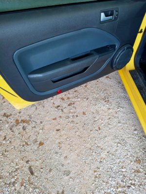

Yeah, I reglued mine using contact cement. Held well for about 2 years. One side began to come loose in the middle, enough to annoy the shit out of me.
Of course it was the passenger side so I got to look at it every time I got in or drove the car.
I said screw it, and got the Coverlays.
My door is black so I got the dark grey for a little accent.
Looks good and the plastic smell almost smells like a new car smell.
