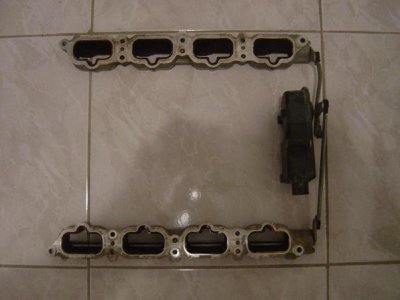

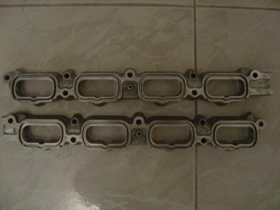

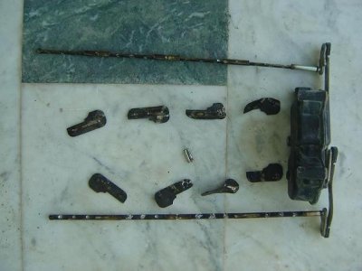

Yes, it's preferable to plug up all the holes between each runner. I used quick steel epoxy on my home made CMCV delete plates and it worked great. If the material around the holes is aluminum, the epoxy will stick to it just fine and turn solid enough to need a chisel to get it out again. Just give it 24 hours to properly cure and then sand the excess down to a smooth finish.
The original assembly:
The pieces I removed:
The finished product:
I've also uploaded a file with instructions on how to perform the conversion.
Note that you'll need a CMCV delete tune to get the best performance from this mod.
