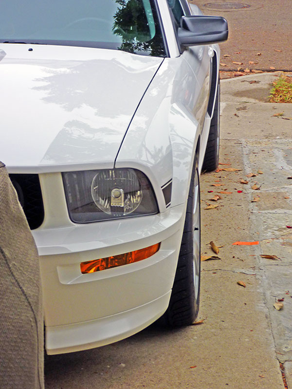

I will get a photo of both sides of my car - I need to adjust my panhard a bit, the tires are close to flush, though.

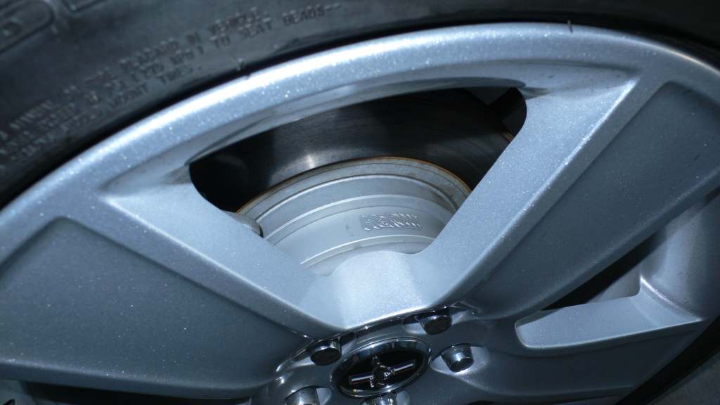

Shows the H&R 25mm (one inch) spacers necessary for 18-inch "Fanblade" wheels to clear the GT500 front brakes. This is a rear wheel. Since the GT500 and GT rear brakes are identical except for pad material, they don't require spacers to clear, but the vehicle is better-balanced aesthetically and physically when they are present at both axles.
The original "Bullitt"-style wheels on Shelby GT Mustangs and GT/California Special Mustangs will fit ((with spacers), but only if the wheel-mounting (hub) studs are shortened by five millimeters; the Fanblades have pockets in the appropriate places, so no operation is required.

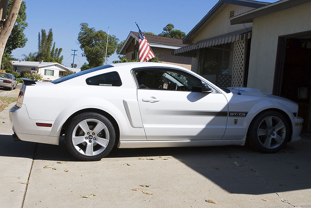

Showing what they look like on a car with "P" springs and 245-45 RE-01 Bridgestone tires (wear rating like 80?):
I did dozens of autocross runs with this setup. The spacer-to-hub nuts were blue-Loctited, and never showed any signs of loosening.

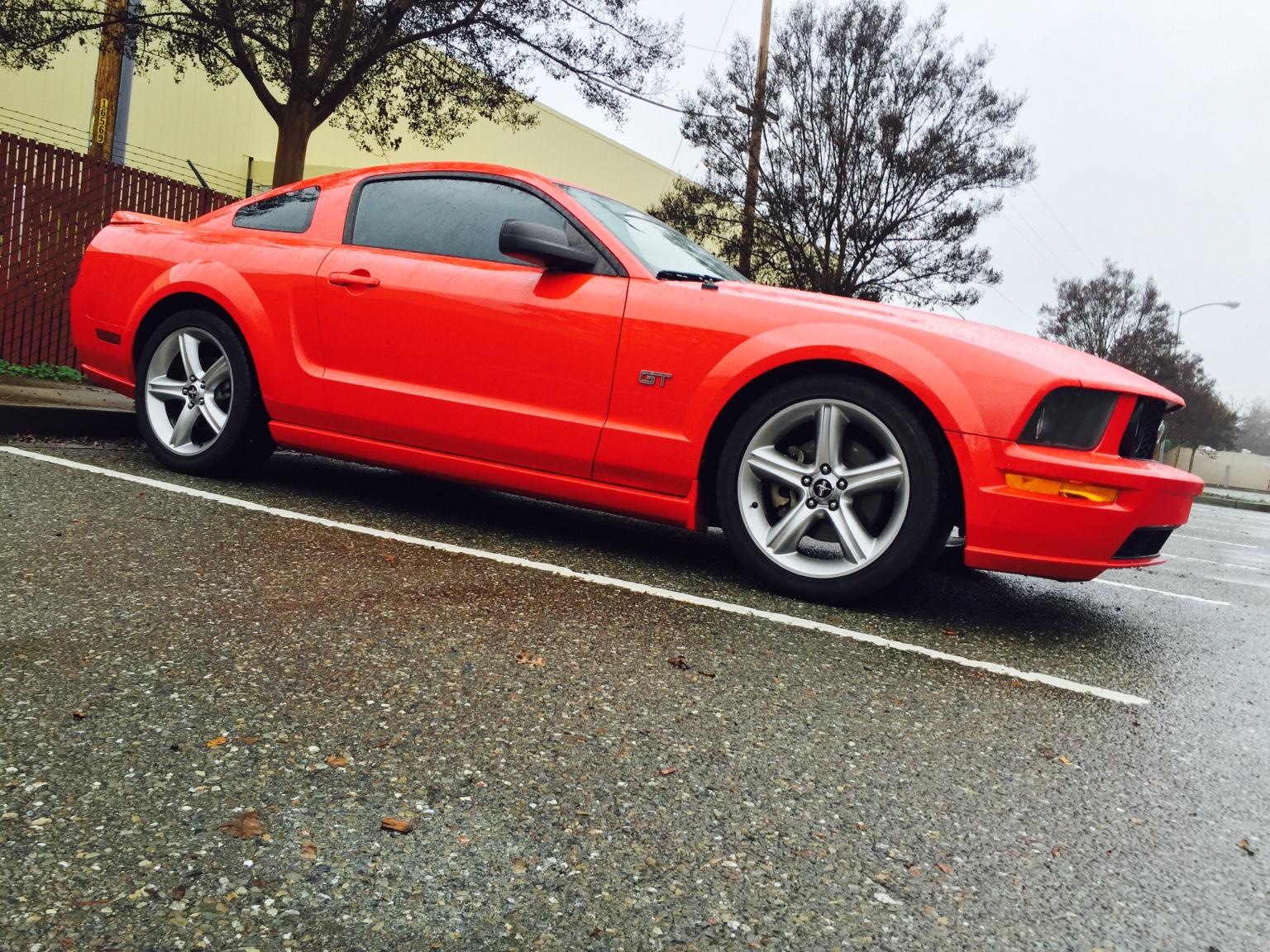

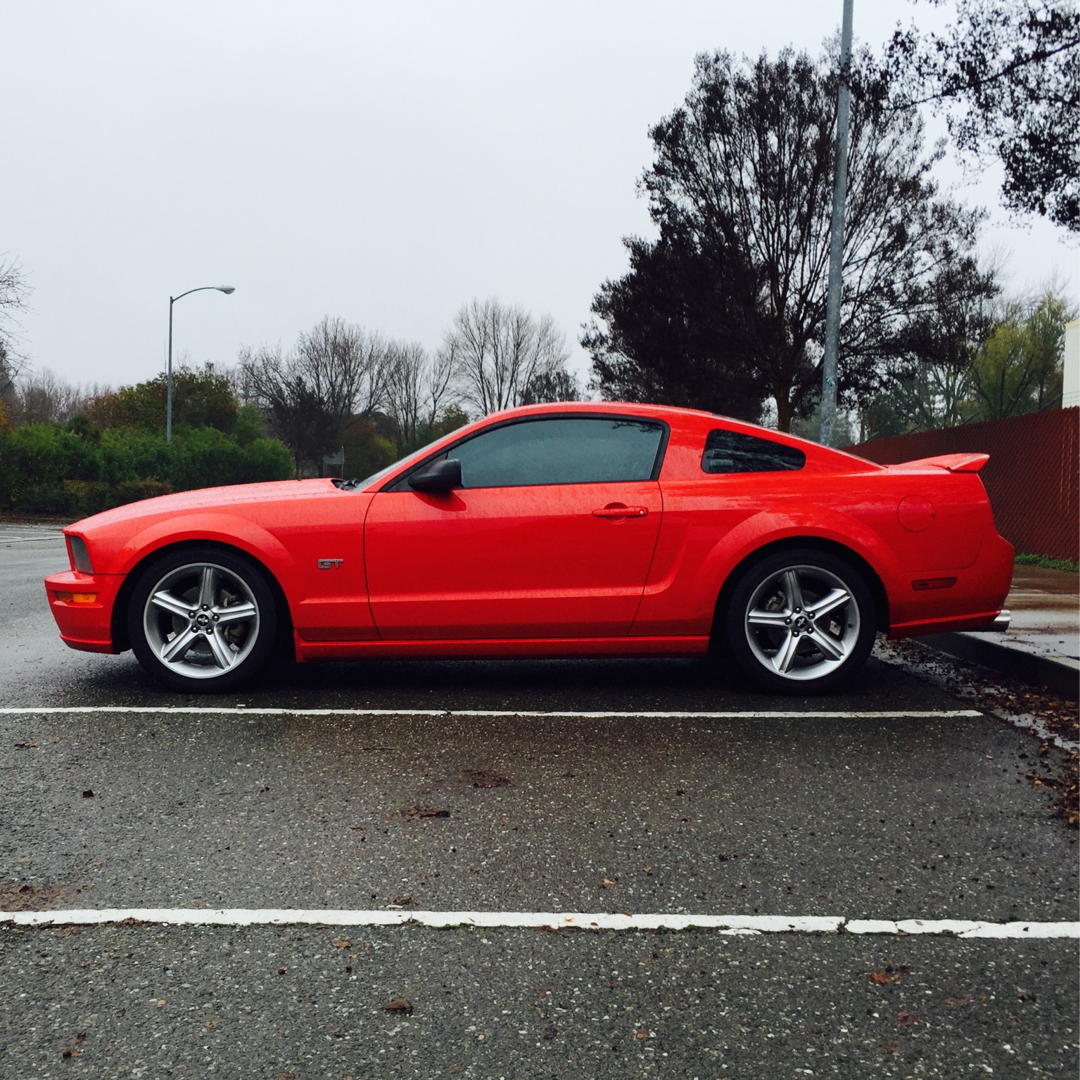

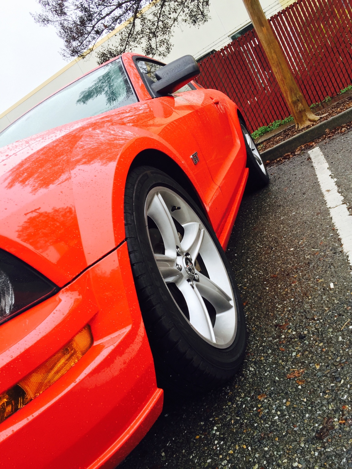

I autoXed and beat the crap out of my car for years on 1 inch ebay spacers. people can say whatever they want. i had the same wheels as you with 255/40/19 bridgestone potenzas. had them on for 2 years and they are fine. now my buddy has them and he has had them for a year and still no problems... i would put spacers on ASAP man!!!
the s197s all are the same chassis so the offsets were the same no matter the year. your gonna be flush with 25mm spacers. that was lowered on H&R super sports.

Wow I really appreciate the post man. Car looks great. I was really wanting to see my rims with these spacers. I also have Bridgestone Potenzas as well. 245s though. Wish I had the 255s.
Since you have the same rims have a lot of questions.
Did you use loctite on the spacers?
Do you ever check the torque on the spacers?
I know it was a while ago but do you happen to remember the seller on eBay?
Did you use them on all four? Or just rears?
Do our rims have open slots (cavities) between mounting holes?
Do I need the ones with the lip? Or without?
Would these work?
https://www.ebay.com/itm/221704982237
Sorry for the question overload
Thank you
KonaBlueBryar
Jan 9, 2015
264
no problem man! and i will try to answer the questions in order.
i did not use locktite, but it definatly wouldnt be a bad thing if you did. when i ran 1.5 inch spacers on my jeep i did just because it came with them.
i torqued the spacers to 100ft/lbs and checked them on and off but they were always fine.
i dont remember the seller on ebay because i actually bought them used off guys on instagram.
I had 25mm , or one inch, spacers on all four wheels, these cars require the same amount of offset for front and back so it makes no difference.
yes they have open slots and the wheels worked perfectly with the spacers.
i would greatly advise the ones "with the lip" which in correct terms means hubcentric. they further assure that the wheel is centered on the hub and wont vibrate.
those look great!!! they have alot of good reviews!!! seems like its a legit company
