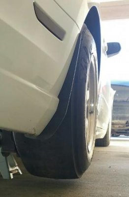

Agreed! So I think I'm going to call weld tomorrow and see what they can do!
Appreciate all the input, anyone else with pictures, I'd love to see them!
