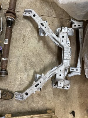

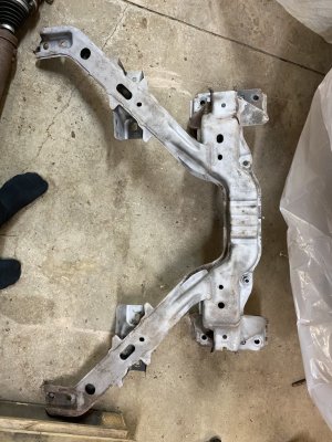

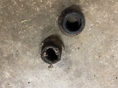

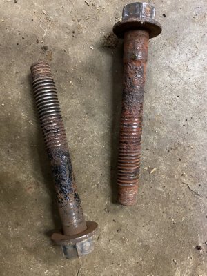

Well the rain beat me out today. Made it about halfway through the k member and the sky opened up. I got a bit of a late start due to a friend stopping by. I hadn’t been able to get the front control arms off. The bolts were stuck on there no matter how hard I tried. I was at the point of torching them off. I had contacted a buddy and asked him to bring his torches. I ran to get some more sand and by the time I came back he was there waiting. He was out of acetylene but even better than torches he had brought his induction heater. If you guys have never seen or used one, you don’t know what you’re missing. It will cherry a nut in 30 seconds and not heat anything else up. The front LCA bolts were frozen inside the bushings. I would have never got them out if I had torched them. This is what Salt does in places you can’t see.

The control arm bolts were welded to the inside of the nuts and the inside of the bushings lmao.

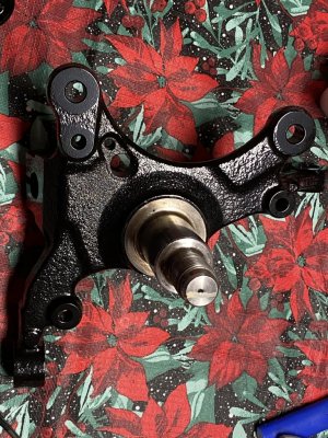

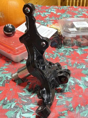

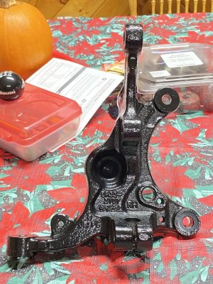

Picked up my Spindles back up today. Nothing over the top. I’m a sucker for Gloss Black. 4BBFC2B5-C569-4239-AC2E-53C7A8BACFA8.jpeg F68C1064-3217-4485-ABA8-2186CDF5DA20.jpegCADB4D2A-CB77-4558-AE77-31CF76AD83EE.jpeg 5C0391FC-554E-4148-BBCF-4246005CDACC.jpegA5B39D0C-8AF5-4020-BE4B-9D5203FF2757.jpeg I’ve got a little more touch up with the sandblasted to go on the K member and rad support. Then I’m gonna drop those off for powder as well.

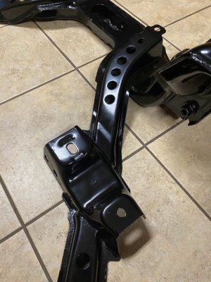

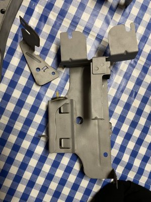

In the meantime.... I got my k member and radiator support back from powder. They came out decent for the shape they were in. They looked great blasted, I almost wish I had just powder coated them clear. Any color will show imperfections but black is really good at it. So you can really pick up all the surface imperfections. I didn’t happen to get a shot of the rad support.

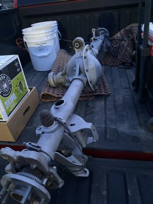

More work on the rearend today. 90% of the putting in the axel tubes removed. More weight reduction, lol. I’m almost satisfied with it. A little more elbow grease then ford light blue powder.

With it that clean, weld the tubes to the pumpkin before getting it powder coated
Any insight on building a jig to ensure that it’s square and straight while it’s being welded? I’m a fairly skilled welder and welding the tubes isn’t a problem for me, but I’ve trolled the depths of the mustang 8.8 and concluded that if I can’t do it right why do it? Maybe you can give some insight as I said. Much appreciated @oldVOR !
1,857
1,266
Make a one inch weld. Role the rear end 180* on the stands and do another one inch weld. Role it back and continue the first one inch weld and then role it again and continue the second weld. Back and forth till complete. Then do the other tube. Been done a million times.
Buy the way, I think your P coated parts look damn good.:beer:
I’ve read this, others say to lay a single continuous weld all the way around. Then the others say it needs to be jigged square and straight then weld the tubes along with bracing.
Thanks for the kind words on the powder. I will likely abandon the welding for now save for a new rear build.

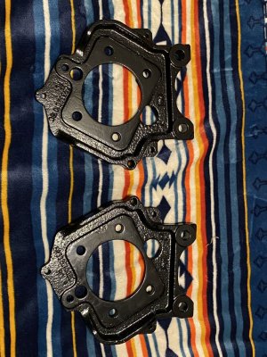

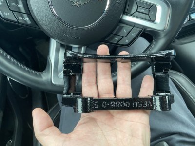

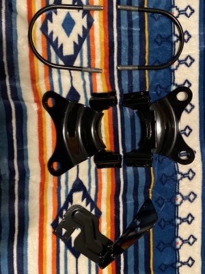

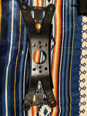

OEM Ford Parts, as god intended them...

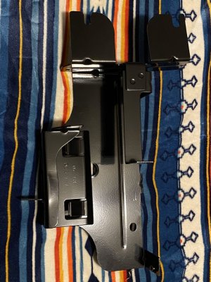

Trans Crossmember
860B685D-9F15-4829-B42A-A3D54E13F9DC.jpeg 66276836-4E6C-48DC-8A4B-600F1FF99489.jpeg
PCM Mount

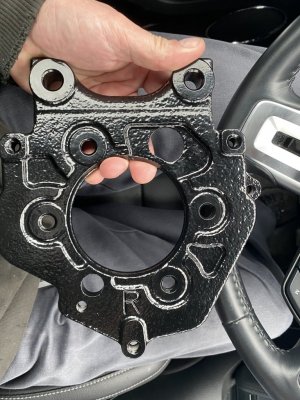

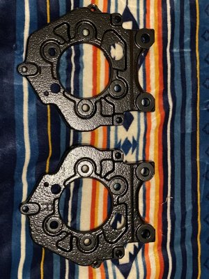

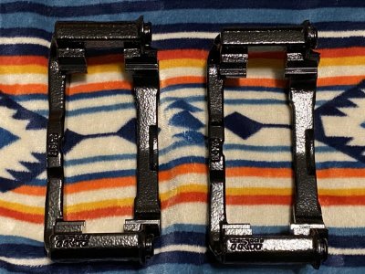

Rear Calliper Mounts

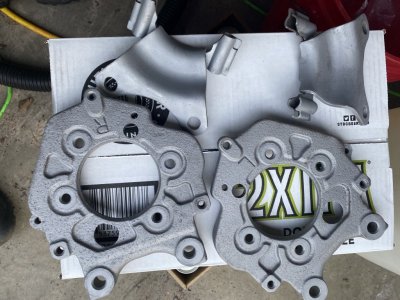

758BC335-1FDE-46B0-9574-0DBB23465C49.jpeg F4FA5CA4-9336-4738-9486-E819692C0503.jpegF74750E9-705E-4905-A1D7-1421B87E067B.jpeg
Rear Caliper Brackets
AC9D70AB-5EB0-43E3-B567-2237796534EE.jpeg AF805B0F-31AA-4B07-AA3A-51ACC58E3EE3.jpeg
