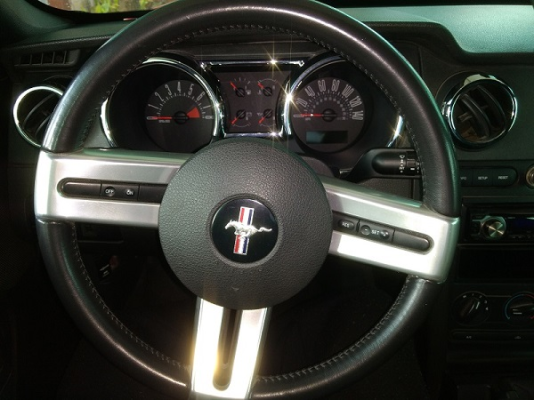

I am purchasing a 2006 Mustang and would like to remove the bright trim around the vents and the tach/speedo and paint them to black. Interested if anyone has done this, and how to go about removing those trim pieces. Thanks in advance.

Removing the trim is easy. Just get yourself some plastic trim removal tools to prevent scratches. I wouldn't paint them black however there are some semi-clear plastic tinting colors including black that would make the trim appear to be black chrome if you're interested in that.

Thanks; so they just pry off with trim removal tools?

Essentially, lower the steering wheel; start with the left side just below the air vent where the plastic splits. Get underneath the upper section with some plastic pry tools and pull straight back. It should come out fairly easily. Then follow the rest of the clips to the right air vents. Been a while since I've had mine out but never any issue getting it out or back in.

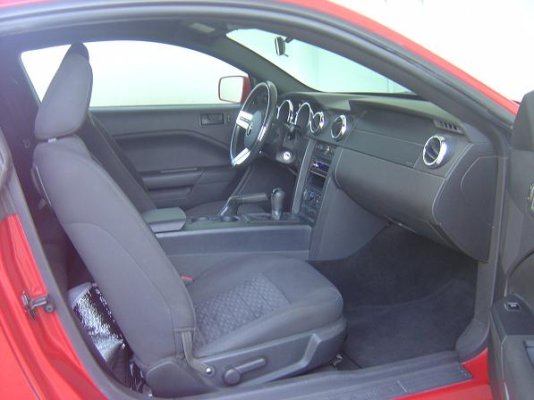

I like mine as they are in chrome. They, together with the brushed aluminium look steering wheel spokes, brighten up an interior that's otherwise black or charcoal.

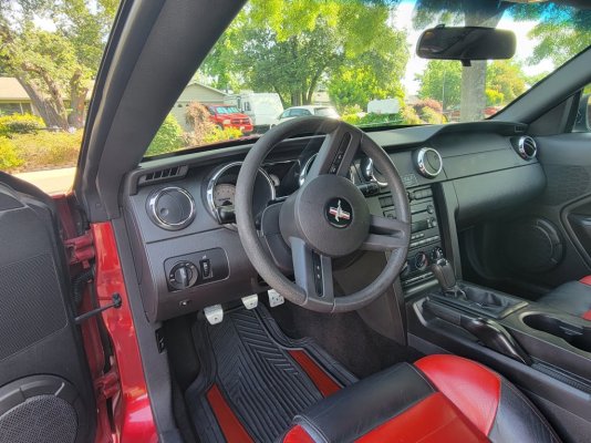

Got it; thanks. Do the bright trim rings around the vents work the same way?

It's very simple. There are a few Utube vids on it if you want to watch them first.
