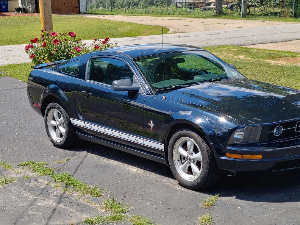

New to the forum. Need some info. From what I gathered is these year models with t5 has a pretty clunky tranny.
My issue is I feel like I'm not getting the most out of my clutch pedal. I have to double or something triple clutch to get it in 1st or second.
Supposedly my car just has a new clutch put in about a year or 2 ago. It doesn't slip or anything. The pedal feel is just off like it's got air in the system. I tried parking on a hill and cycling the clutch to work air out of slave but it didn't seem to do much. Feels like it gets marginally worse once car is fully warmed up. Something 2nd won't engage and will keep me locked out for a while until I can force it in like it's bound up or something.
Planning on swapping tranny fluid but was wanting to know what else would be the problem with clutch not disengaging.
Periodically it feels like the clutch will drag when I press clutch in while coming to a stop because the rpms will drop to 500 then jump back up to idle
