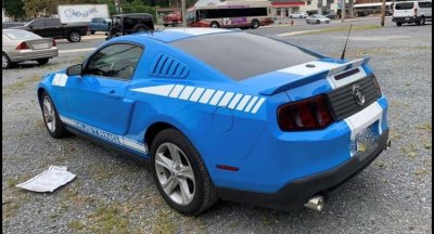

trying to learn about this generation and mine does exhaust upgrade already with from what im understanding the gt rear valance to accept the exhaust. question about the stereo in this. Is there 3 version of the shaker ? why i am asking is i want to say i seen ones that say shaker 500 and ones that say shaker 1000 but mine just says shaker. There is no 500 or 1000 on mine. From what im learning is the 500 foes not have the amp and subs in the trunk. Is that the only differences ? Mine also has the sensor by the dash vent and the sensor on the trunk. but what sux is that Ford no longer supports the "Sync" in my car. would be nice to utilize its features but swapping out the head unit looks pricey. Mine also has the controls on the steering wheel

What wheels are those? They don't look like any factory Mustang wheels I've ever seen. Explorer maybe but Explorer wheels have the wrong hub bore to fit Mustangs right without modification.
