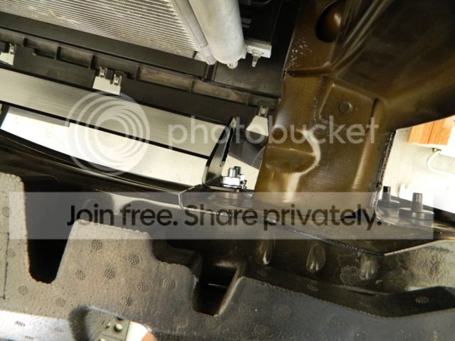

How tough was the tow hook install? I'm doing 3-4 track events per year and have yet to get the guts up to cut a hole in my car :/
not too bad. having an oscillating multitool (e.g. Rigid Job Max) makes shaving the foam a piece of cake. I tried doing it with a knife/saw on the rear bumper foam--total waste of time. the hole in the bumper isn't difficult to mount with the little "needle" attachment.
whatever you choose to do, get some sort of tow hook. if you're stuck without it, it can ruin your day.
If you would rather not cut into the bumper cover, check out the tow hook from Blowfish Racing http://stores.blowfishracing.com/-strse-2/2010-dsh-2013-Mustang-Front-Tow/Detail.bok
Fits and finish is first class and I use the bracket to mount my front license plate when I'm driving on the street.
