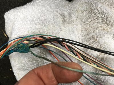

Apr 19, 2015
Leaky trunk
This my first post on S197 about leaks. On my '05 where the water flows down the trunk trough it goes behind the tail light and directly over the center fastener. My trunk has finally stopped leaking after putting some dum-dum around the bolt holes. Fast forward my left directional signal stopped working so I replace all bulbs. Still not working started opening up the wire loom and found that a ground wire in blueish foil was rusted and the foil cover was all rotted away. Well the water that came in tail light hole also dumped directly into the wire loom for about 18". I think this was designed by some jokester. I'm not laughing.
