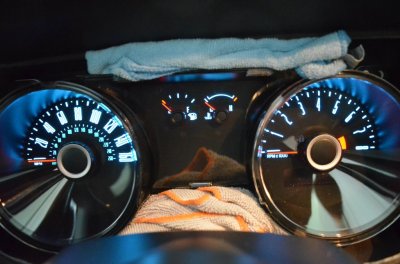

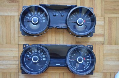

Thought I would start a tread on my adventures of doing a Mustang Base to a Track Apps swap and update as I go. I found two clusters. One from a 2014 6cyl Mustang from $125 with 18,000 miles and another from a 2014 GT with 28,000 miles for $200. I am going to buy both. The GT is within 1 hour drive so I intend to pick that up soon. The other is too far to drive so they will have it shipped. Right now I have a little less the 18,000 miles on the Base Cluster. I already installed what is called the "OK" switch which works with both the Base and Trackapp cluster. Picture of Base Cluster to be replaced.

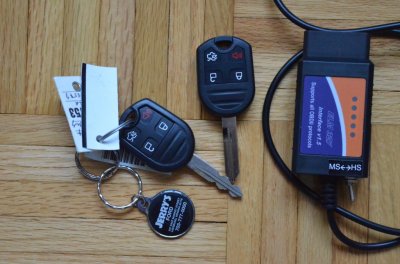

I am going to get a new key cut today and try to program it. It's a $10 Chinese knockoff. So this may or may not work. The Forscan connector does work but I will first try to program the key without it per Ford instructions using 2 original keys.

This time it worked. This morning the Ford dealer cut the key for $5 and I followed the procedure for a new key and it works without Forscan. I will order a few more.

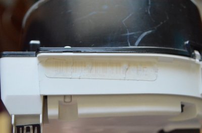

A little update. After my Track Apps Cluster sat at the Junkyard for 2 days, it's finally on the local Fed Ex delivery truck. This is the 6cyl auto one with 18000 miles. Not sure it's going to be plug and play. Found another one for $75 with 38000 miles same deal 6cyl auto and I told the junkyards I wanted it. It will be shipped next week. I will use it as a back up. The search engine part number is D or ER33 10849 EA to EJ. The Fed EX one is an EE. Many junkyards do not know the difference between clusters. A Cluster is a Cluster. They can want from $50 to $250 for it. The local cluster for $200 was way too much trouble. I found another cluster for $85 from a GT 6 speed in mid USA with 40,000 miles. I might buy that one also. The part numbers are all screwed up so you got to have the junkyard send you a picture. Actually they are nice about this because they don't want you there due to Covid. These track app clusters can be on any Mustang from 2013 to 2014. It seems leather seats is a clue but not always. The "OK" switch is a sure sign. Lots of wrecked Mustangs out their with between 40000 and 80000 miles. Most have basic clusters.

The cluster was delivered around 2:30 today and it looks good. I cleaned it up. I may or may not replace the lens. As you can see from cheap ink, the stock number sticker is all by gone.

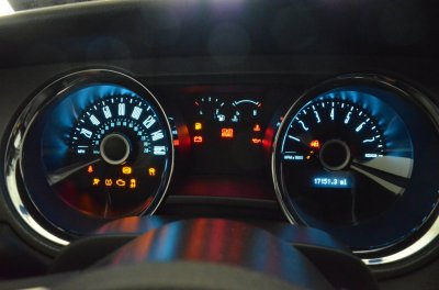

Got the old one out. Not easy unless you do it all the time. You really have to man handle it. My lens looks a lot better then their lens.

It's 1000 miles more then the old cluster but it seems to work.

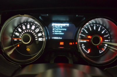

So everything seems to work even the warning lights for the first few seconds when I turn on the key. All the center fields work but no Track Apps. Again this is from a 6cyl car. The big plus was the cluster, it was within 1000 miles of the original cluster.
So now a PATS reprogram and then I guess the following changes need to be made in the ABS with Forscan for Track Apps.
720-01-01 = F798 EF61 08
720-01-02 = F80F 0000 31
Then
760-01-01 = 056E for Brembo Brakes.
I will do this when the second key arrives Monday.

The hard parts so far. The dash cover just doesn't pop off. You must manhandle it. The two screws can fall into the dash. The cluster connection is hard to reach. The bottom clips really hold on to the cluster as much as the dash clips. The new cluster is hard to reconnect because the connector has a very short lead.

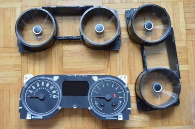

Little update. I purchased a new lens for the Track Apps Cluster. It was $40 from the dealer and made in Mexico July 2020. So with that, I have $180 in a 18000 miles cluster and it looks new. The old cluster is still in the car waiting on the new one. There are two different cluster lens. One for the Base titled "A" and the other for the Track Apps titled "B". They do not interchange.
