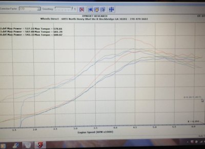

20210220_171947 (1).jpg Here's my car on 6.5lbs with the Brenspeed turbo cams/70mm On3 turbo. Car starts to really pick up at about 3000 rpm.
