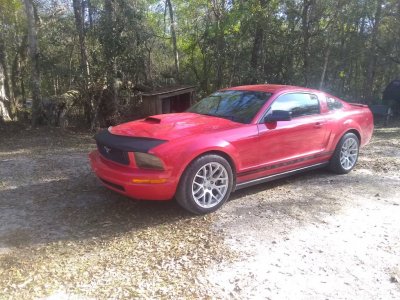

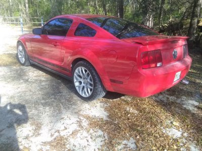

The "Car" has come to life. Re manned long block with all the upgrades, like timing chains, gears, guides, tensioners, head and block work, all the normal stuff. Aluminum thermostat housing, water pump, radiator, blue hose kit, K & N cold air filter, dumped the hollow "muffler" that the kid had on there which made it unbearable to drive any distance due to the "Drone" inside. I fabbed the mounts and put a Hush Thrush on it. Has a growl, but zero drone. Now I can hear the stereo. The power is the same, low end feels a bit better actually. Oh, I also scored a set of wheels off Facebook marketplace today. Looks so much better. enjoying the car now.

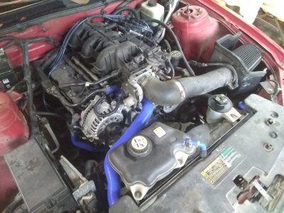

Gettin there... any pics of the engine?
I'll shoot some and post tomorrow. It's a fun car to drive. Having a stick car really puts the driver back into the driving process. I grew up on sticks. My Focus (wife's car" and my F150 and Bronco are all automatics. Also, having a baase car without the ABS/TC and shutting off the TPMS is really nice, no nagging lights and brake pulsing. I'm enjoying it.

Nothing special really. Just Cold air, blue wires and blue cooling hoses. No supercharger or turbos, yet.;)
