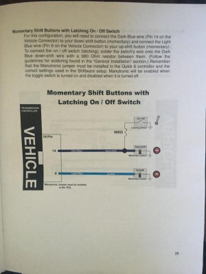

It functions like a normal trans with it in drive. I have a switch that activates the Manutronic setting as Quick 6 calls it. Then the button is activated on the shifter and you can manually switch gears up or down.
Why is the extra switch needed?
drive_55_not
Sep 29, 2011
622
20
I pulled up the Quick6 manual and it appears they are enabling Manutronic Mode by pulling pin 14 low ..
Also answered my question about the shifter, Manual shifting is fully controlled via the Quick6 pins 14/6 ..
They​ also have a line to select in the software for it to activate on startup, but I assume if I fid that it would only shift via the up down buttons. I think I will go the momentary button route.
