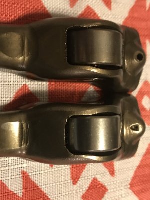

A customer had a set at the machine shop that I used and they had all the same stampings and machine markings as my 2009 ones so not sure how your 2010 could be different from them. We even had to guess at which lash adjuster was the new one and which one came out of my engine. Watch the video on American Muscle, they even state that you are not getting anything different from OEM.
Your machine shop customer was feeding you a line of bull shit. Anybody can hold the production follower and the updated one side by side and see the difference.

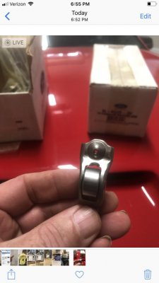

Just saying, we took them out of the ford racing box, sealed by summit racing.
And I build my own stuff, the machine shop wanted to see if they were the same, they were.

The smaller and differently shaped oil hole in the updated follower is unmistakeable when compared to the round oil hole in the production followers. That is my point. Whether the change affects oil pressure or volume I do not know. I read a long time ago the biggest problem with the 3V oil system was the leaking oil pump backplate. The FRPP 3V pump with steel backplate solves that. I am running a Comp cam and springs and haven’t had a bit of trouble with the valve train so far. It sees 15 lbs of boost and seems to like it.

For those that aren't aware of what Midlife Crises is referring to concerning the cam followers here is a picture of the new Ford redesign beside the original....the new design is the bottom one in this picture:
Also
Your phasers control your vct, not your followers
Also
