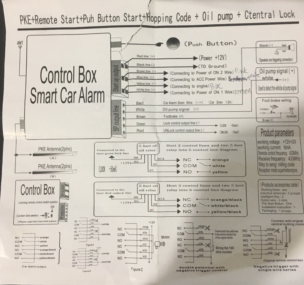

Here is the wiring diagram for the unit I’m trying to install:
I just really need to know if I tap into the the factory lock/unlock wires at the SJB that it will disarm the factory alarm as well.
