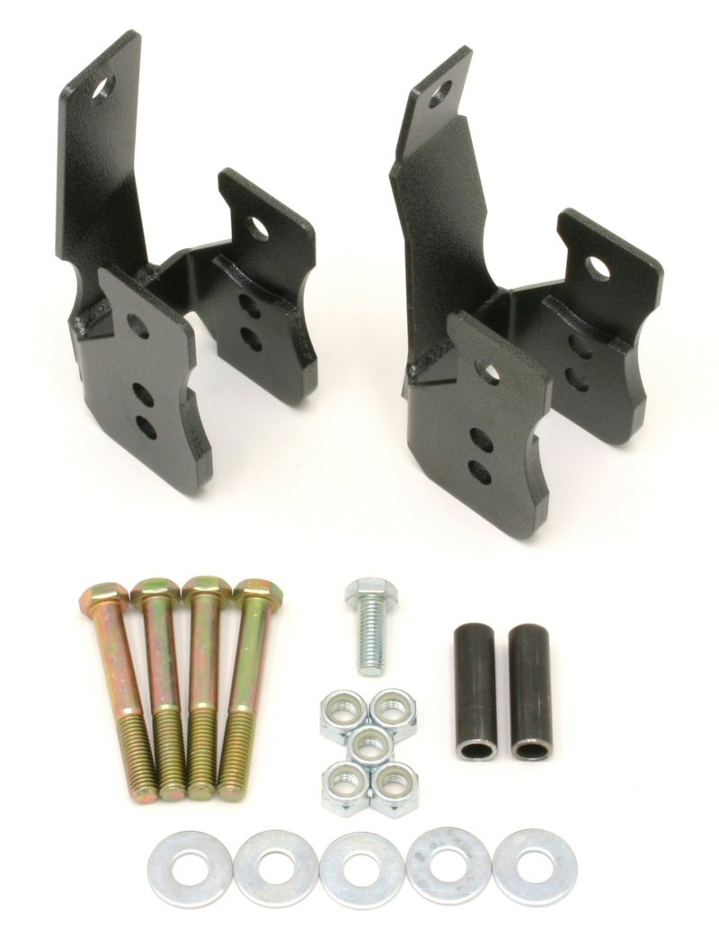

Our first set that we developed in 2004, were weld-in only:

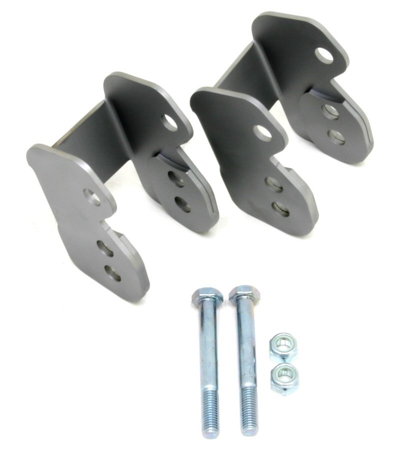

Then of course, we realized people wanted a bolt-in version. So somewhere in the late 2005, early 2006 range - we developed a bolt-in version. These proved to be a hit, and were quickly found underneath the majority of S197 Owner's cars, who were looking for improved traction:

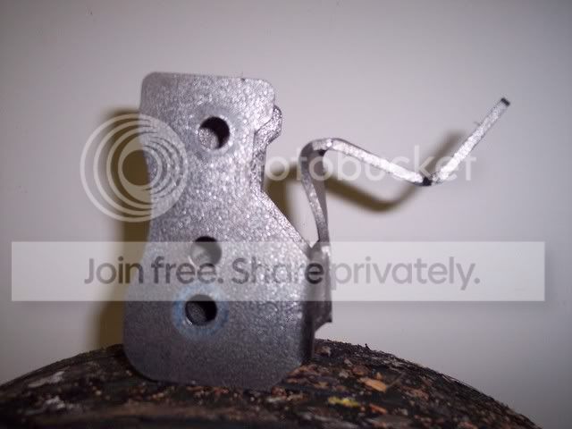

This product was an excellent design for the majority of S197 Enthusaists - however; we DID have an issue occasionally with people bending them when drag racing without welding:
As you can see, the sticky tire this bracket sits atop, proved to be too much for the back-strap on this piece. We were able to squeeze some pretty impressive sixty-foots out of these back then (1.33) without welding, but the true test is when thousands throw them on a thrash them. We ended up recommending welding to these, if drag-racing the car.
As time went by, we were destined to come up with a design that did not need welding, regardless of the subjected abuse. We simply became to large, too quick, and just could not fit the time into our schedule to redesign this piece.

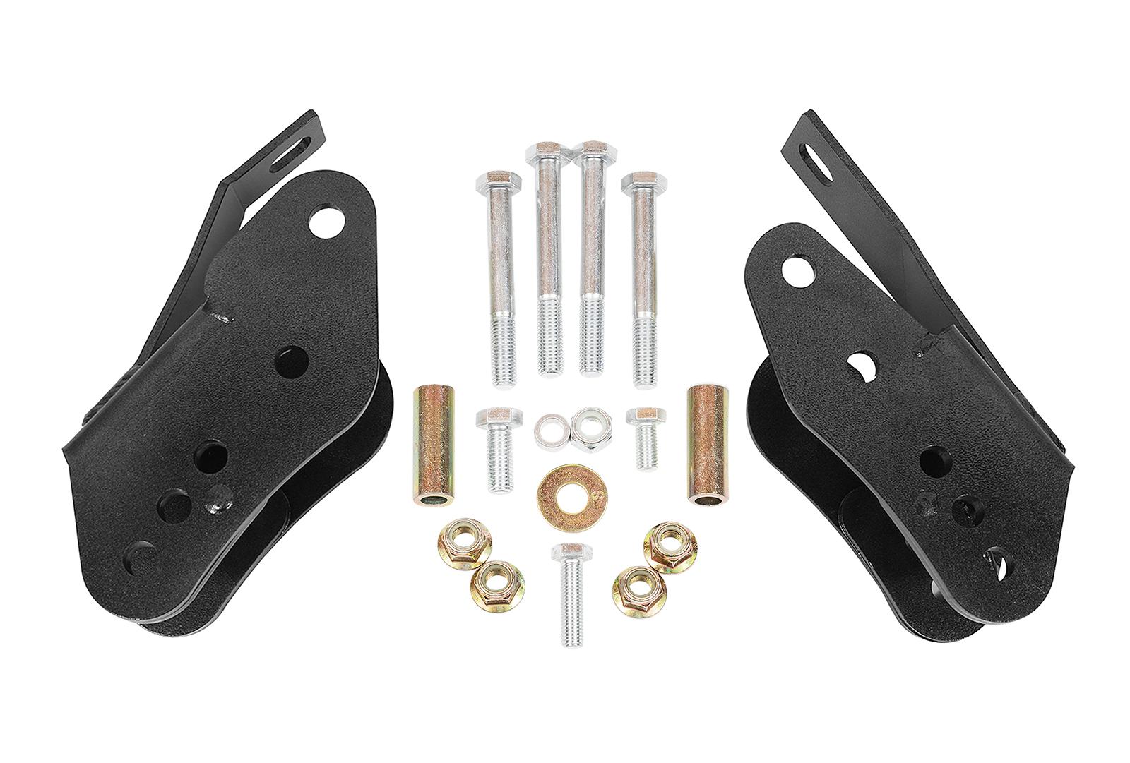

The current BMR Relocation Brackets:
Click to see the current bolt-on design on our site:
2005 - 2014 Mustang GT | Control Arm Relocation Brackets | CAB005 - Control Arm Relocation Brackets, Bolt-on | BMR Suspension - The Leader in High Performance Suspension & Chassis
Of course, the version on our shelf right now, is even slightly different from that image above. We slotted the upper back-strap holes, and have fine tuned the actual mounting point holes to help with the production tolerances on the OEM vehicles (primarily the damper-weight bolt hole)
This current design, since 2010, has seen no failures. We may have only been making them for about 3-4 years now, BUT, we have sold more of this design than all of the previous versions, combined.
