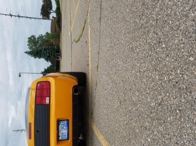

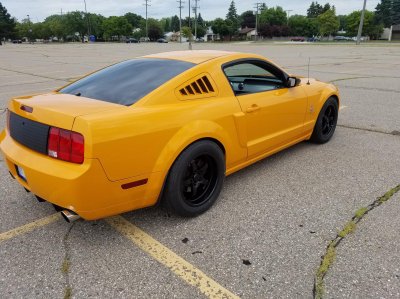

My car is a sunny day streeter, and will maybe see the strip once or twice a year, couple pics below (currently SVE drifts 19x9.5" at all corners, 275/40-19).
Hufen's wheels are 18x9.5 and 18x11. I'm stepping down from a 19" wheel (and previously 20"), so would like to fill up the wheel well with a 28" tire if possible. The two tires I'm looking at are a Nitto 555r 305/45-18 and M&H DR 325/40-18. I ran 555r's on 20" wheels on my last S197 and loved them. I don't know much about the M&H tires, but honestly they are the only other manufacturer I can find that makes a DR/extreme summer tire in 28" tall.
1) What are you guys thoughts on the two tires above? Is a 28" DR going overboard on a (mostly) mild street car (450WHP)? Are there any other options out there? I don't need that "steamroller" look that a lot of guys are going for, so I'm fine with a 305 tire (but don't have anything against wider either!).

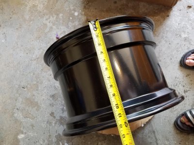

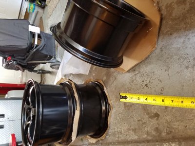

Thanks for all the feedback guys. Hufen's wheels just showed up today (man, they are monsters.....), so I'm going to pull the trigger on some rubber soon.
I have the Nittos in that size. They are awesome. But I think that are closer to 29". If you are lowered at all they will rub.
I'm glad you mentioned this..
I am lowered on Steeda sports (IRC 1" and 1.25" drop). The current setup on my car (275/40-19) calculates out to a 27.7" tire height. The 305/45-18 comes out to 28.8" Just doing a quick measurement, I think you are right that I won't have enough clearance to fit the Nitto 305/45's in the wheel well. The M&H 325/40's (calculate to 28.2") might be feasible.... I attached a few pics for you to take a look at.
