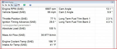

Here is a screenshot of a HPtuners log. Looks like its staying open to me. and hptuners always shows a max tp of 77%. i don't know, unless hptuners is missing something which is entirely possible cause they are missing a table for commanded lambda for timing and KR doesn't work with fords on it.
Max TP is 82% on everything I've seen. (SCT stuff)

yea i don't know why it does that. all the gm stuff i have dont with hptuners always reads 100% throttle. but it was just showing you guys according to that, my throttle stays 100% open till the limiter.
