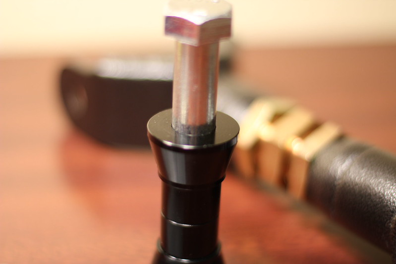

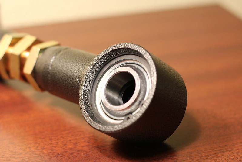

Anyhow, enough with the babble. Here are some pictures. Massive spherical bearing.....and notice, one of the races is slightly different - that sure would be a nice feature, huh?!
Outer race w/ (2) potential bearings to be used:

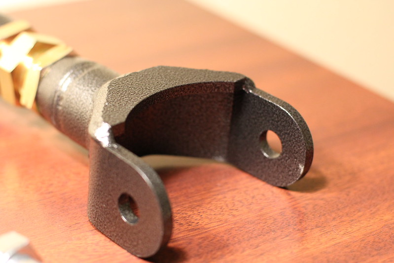

Hmmm....
Current Poly Version / Mocked Spherical. This things is rather large....
2005-2010 to 2011+ Comparison. That "little" Spherical UCA on the right, has seen 7-Second ET's, MANY 8's and 9's +...and can be found on many Professional Road Course cars. That Hammertone Bearing end, ironically, fits a Cobra Jet UCA perfectly....and many use an an upgrade...

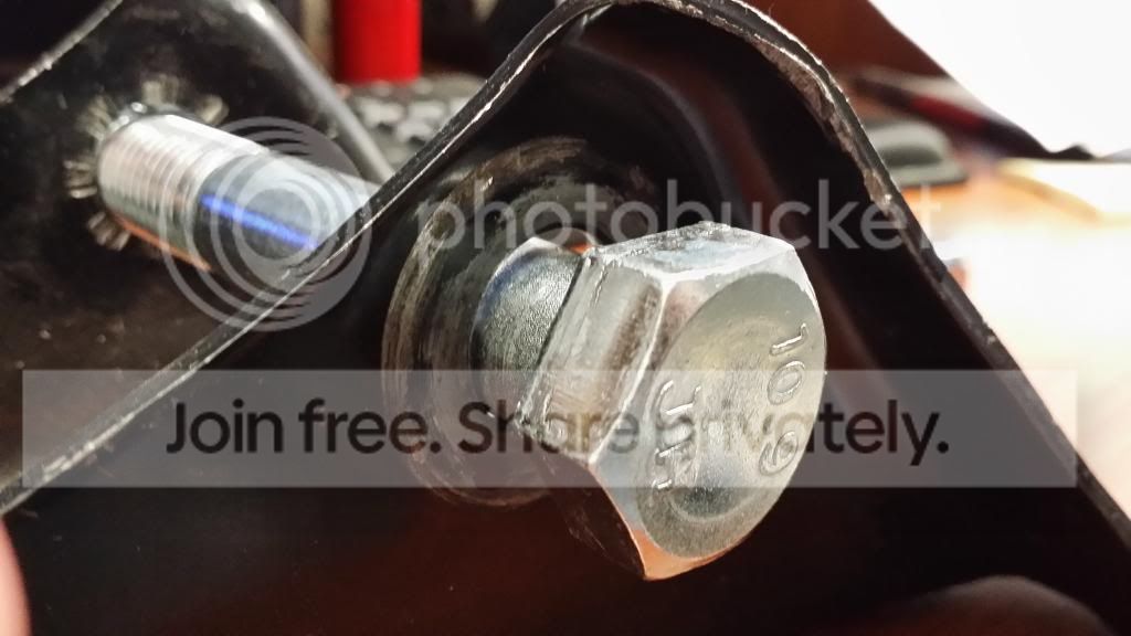

One of the primary difference is strength. Your typical Rod-Ended UCA is just not as strong, due to the design used to make it work. The weakest way to build a control arm, upper or lower, is to have a "small" threaded portion of the UCA. Here is a very good example of what I am trying to get across. Check out these two arms - which one is stronger?
The next difference would be quality. Have you seen the MMatic/FRPP Boss 302 UCA? It is $800, from what I am told....and it does not use a Rod-End....it uses a housed spherical bearing, similar to what you see pictured ^.
At the end of the day, some may not want a higher quality piece. At this point and time, there is no other item like this on the market - and we are going to be the ones who release it, and offer the only true adjustable spherical bearing arm, that you can buy.
There is nothing "wrong" with a rod-ended UCA - but we learned back when stock suspension Drag Radial Mustangs were getting into the 8's....that rod-end UCA do not hold a candle to a housed spherical bearing design. We used to have a box full of borken rod-ends from customers who we supported locally, that were running out of the box rod-end arms on their 1300HP Mustangs.....this is why we designed and released our Spherical Bearing control arms for the '79-'04 cars....even though we don't sell but 5 pairs a year due to them not being $150....
I have a spherical/rod ended UCA in my '07, and never again do I want one unless I trailer the car to the track. Works great at the strip, but is god awful driving to the track.
Looks like it will be a nice piece though.
I assume it is a typical rod-end UCA like pictured above? Thanks for sharing!
