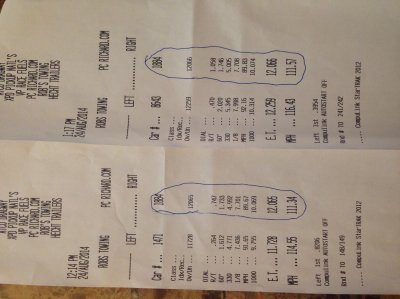

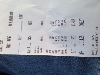

May 30, 2014 I took the car to Atco for the first time ever. Ran 11.96 at 114 with a 1.7 60ft and no spin. IAT's were 150. Tune started pulling timing at 130.
After this I installed the Afco dual fan heat exchanger and Lund adjusted the IAT's to pull at 140. Also I had a bog if I stabbed the gas from idle and he fixed that also.
August 24, 2014 Back to Atco. I ran the car and the IAT's were 120 so not pulling timing and the 60ft was again 1.7. 12.06 at 111 mph. Disappointed I ran two more times and no kidding I got 12.06 at 111 mph every time.
My problem is I thought the car would be faster now that I have full power and not pulling timing. I feel as if the mph is not reflecting the hp I am making. In May the car was pulling timing before the run even started. Now the car never pulls timing and I have logged and checked and it stays at 19 with no fluctuation at full throttle to redline. I'm not sure what to do?

Time slips from both months. Car 2024 in may

the small difference in 60' and mph at the 1/8th could be explained by different DA or track conditions:
60' = 1.71 - 1.73 - 1.74
1/8th ET = 7.63 - 7.70 - 7.70
1/8th mph = 90.70 - 89.67 - 89.83
So less than 1 mph difference from the last time to this time on the 1/8th. But look at the mph at the 1/4
1/4 mph = 114.65 - 111.34 - 111.54
So you have a .87 mph difference at the 1/8th, BUT you have a 3.11 mph difference at the 1/4. Something is happening on the big end. Assuming you haven't changed anything from the two outings (you eliminated the tune pulling timing), you are using the same gas, same gearing, same tire, etc --and the DA is pretty much the same then:
1) change plugs
2) look at your rpm data log on the big end, does the rpm fluctuate? If the rpm is fluctuating/jumping vs a steady increase in rpm, then your converter is locking/unlocking or slipping. If so your stock converter is starting to go away.

I suspect you are going off the date on Atco's timeslip which was off by a day for a while this year since the 30th was a Wednesday so I'm guessing you were there on a Tuesday night which would have been the 29th. The weather that day/evening looking at the Drag Times DA chart was phenominal... the barometer was 30.17 which is crazy good and the temps from 3pm on were 60F down to 55F so you had killer air then.
On Aug 24th (this past Sunday) the barometer was still good at 30.10 - 30.14, the temps were 72F - 80F which makes a huge difference on a blower car on gasoline. Another thing to consider is that the track prep on a test and tune day like this past Sunday isn't going to be nearly as good as a Tuesday night gamblers night or a Saturday points race day so that could have played into it a bit.
Atco is my local track so I'm there at least two times a week racing so I am quite familiar with how the track changes on certain days.
How were you checking your IAT's? Datalogging or interceptor gauge?
I am inclined to say a lot of the change has to do with the air difference in the two days. I can a swing on my car of a few hundreths of a second in a single day as the air changes...you're looking at a difference of a tenth which I can see as feasable given how different the air was between your runs.
