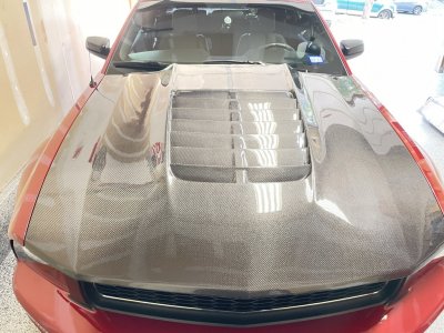

Sorry if I there's something already out there I tried searching but didn't find exactly what I needed. I got a new carbon fiber hood and had to use the old prop because the gas struts I had previous are too strong and may cause damage. I'm looking to see if anyone has found an alternative to propping the hood open or possible ideas. I was thinking of drilling out one of the holes in the hood struts so I can snap it on/off when the hood is up. Let me know what y'all think, thanks!

I haven't measured the travel yet was hoping someone already went through the trouble lol. As for the hood itself it's really not that sturdy compared to the aluminum one. It's a carbon fiber shell on a fiber glass mold if that makes sense.

I also have a carbon fiber hood going on, the Redlines look like the way to go. Carbon fiber are lighter than fiberglass, struts with less PSI are needed. Fiberglass uses heavier struts. Too much PSI will fold the hood like and older chevt truck hood.

The issue, compared to the stock hood, is the flex of the fiberglass or fiber hood. The strut pushes up on it while closed and the aftermarket hoods that aren't aluminum will bow eventually.

Are you planning to get that clear coated? I really like that hood, but not sure if clear coat is necessary.
