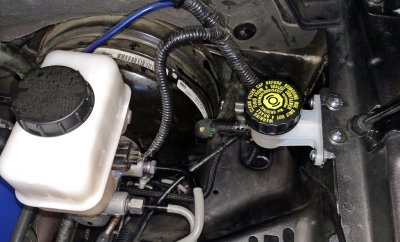

When I installed the new clutch line I also wrapped it with DEI heat tubing. I also have ARHs but are ceramic coated. No problems, Oh yea I also relocated a new res.
