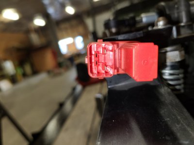

Grey female 3 wire is 1st pic, 1 wire is black/yellow, another is green/purple, last is blue/pink

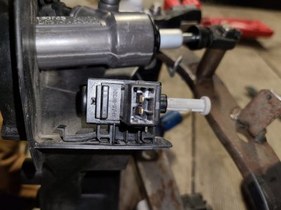

Cruise deactivation switch plugin is 2nd pic

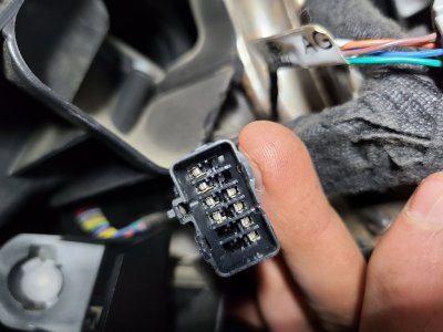

Neutral safety switch plugin is 3rd pic

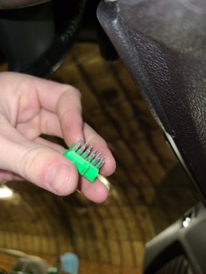

4th pic is the only other electrical connection not being used but had the green insert in it.

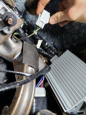

5th pic is the green cap

I don’t know what harness you need “if any” to make that clutch pedal circuit work but I believe you have the wrong switch. That circuit will work with a single pole double throw switch. The black/yellow wire is grounded and would be the common side of the switch. The green/violet wire connects to the normally closed side of the switch and would deactivate cruise when opened. The blue/orange wire connects to the normally open side of the switch and will allow engine crank when closed.
If I remember correctly my 2010 GT actually uses two single pole switches to do the same thing with the three wires. One switch is NO, the other is NC.
I tapped into the blue/orange to use as a trigger for a two step.
