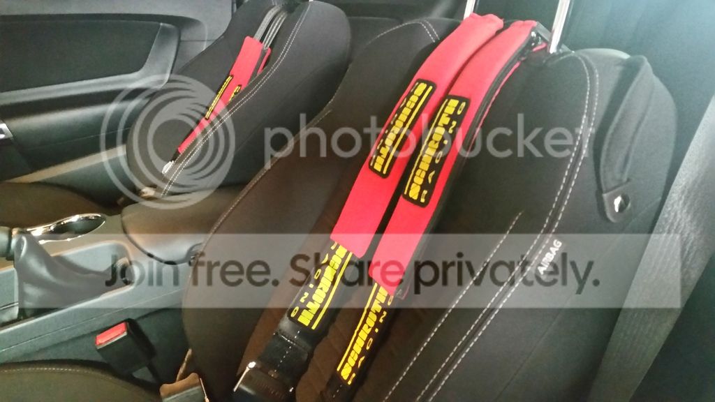

FWIW, my Schroth Rally3 Harnesses and pads arrived today. Got them installed for autocross use anyway. Of special note, the rear seat upper belt attachment point isn't an attachment point so much as a redirect. The actual belt reel is down along the base of the seat and as such it does not work as an attachment point for the Rallye 3 Harnesses. I opted to install the belt in the lower outside seatbelt points which violates the 45º angle mounting rule. The lap belt attachment points were attached to the rear seat anchor points as the lower outside mounting point for the factory 3 point is buried under plastic coverings that would have required extensive modification to work correctly.
If a harness bar ever exists for this car, it'd be worth the install to save headache.

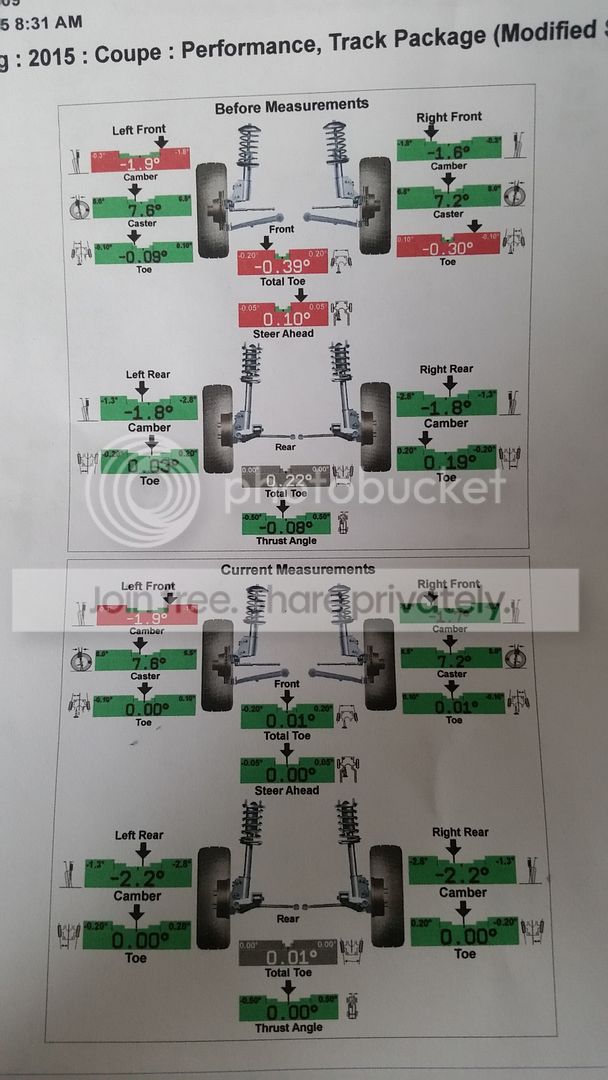

Well, official alignment is done and here are the final numbers:
Front Camber: -1.9 and -1.7
Front Toe: Zero
Front Caster: +7.8 and +7.2
Rear Camber: -2.2 and -2.2
Rear Toe: Zero
Not sure how all the rest of you F-Street guys got into the -2.0 and more negative range but I guess you are the lucky ones and the factory stamped your struts differently! :)
Factory alignment was pretty far out of whack with regards to rear toe... total toe was fine (.22 in) but the split was absurd (.03 on the driver side and .19 on the passenger side)Issue resolved and zero thrust angle so the IRS is at least square to the chassis.
Here is the before and after:

Did you install a harness bar?
Nope, none that exist at the moment. The Schroth Rallye Harnesses can be installed in the lower rear seat belt positions... I don't suggest daily driving with them that way as it puts enough of an angle on the belts to make me uncomfortable with what would happen in an accident. Good enough for autocross duty though and that is where they'll be used.
kdaly1
Apr 7, 2015
14
10-4 I need harnesses for my car, but I dont want a cage and everyone states the harness bar is more dangerous then helpful. I am using my stock seatbelts with aftermarket seats. I was interested in what you had done to see if I could do something similar.
Whiskey11
SCCA Autoscrosser #23 STU
Feb 24, 2012
1,644
For autocross or track days? If autocross, there is nothing wrong with what I did in my car. For track days, I wouldn't put a harness in the car until you have some form of rollover protection.
I also wouldn't recommend wearing the harnesses on the street from the standpoint of, even though the ones I have are DOT approved, they are not designed to work with the specific airbag configuration in the car or the seat or really any of the safety stuff in the car. That's why you improve the safety of the car with them for track days.
At this point I havent done either. Just finished getting the car this way and I'll do track day eventually but I have no concrete plans as of yet.
So as of now it would be to use when I'm driving it. BTW its not my DD. I guess I can just use the stock seat belts, but its not ideal. I wish the harness bar was a better piece.
