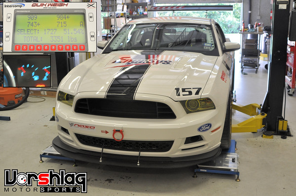

I am looking for somewhere to take my car near Greensboro, NC to have it corner balanced. I know that you want to cross balance so that LF+RR = RF+LR. My question is do you try to move the weight to the rear as much as possible while obtaining 50% cross weight, or is where the weight ends up just a byproduct of trying to get the corners at 50% for each diagonal?
How big of a difference is it in handling Terry? I am just trying to spend the funds wisely and try to get the most bang for the buck.
