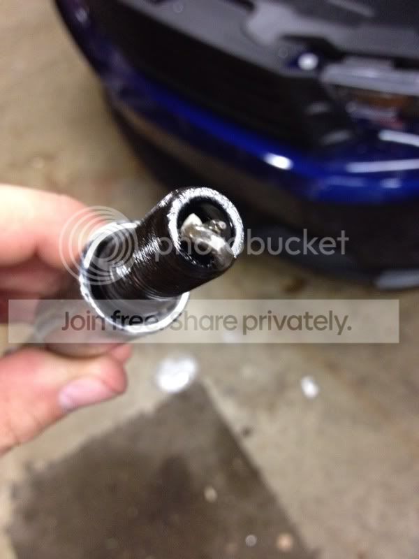

This is my #4 spark plug I took out

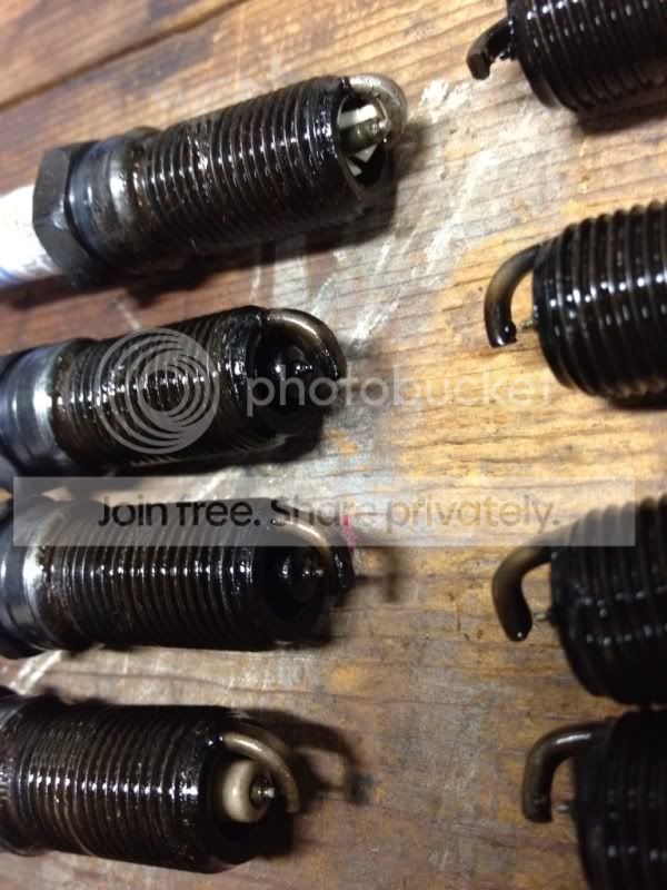

This is what my plugs looked like when I took them out, they are arranged as if you are looking at the front of the car. Front left is 1, rear right is 8.
A few (2,3,8) are darker than others.
Here is a shot with most of the stuff taken off the engine, DAMN there are a lot of plugs on this motor...

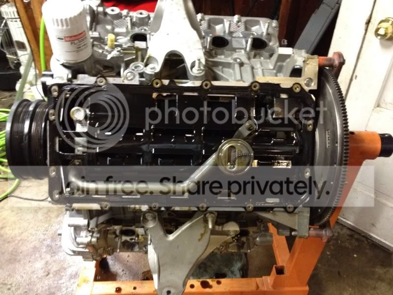

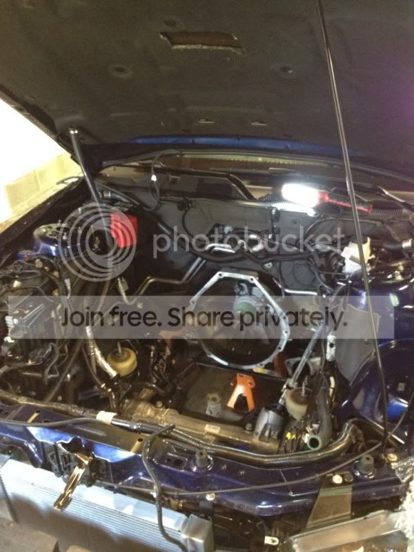

Here is the motor out
Here is what my bay looks like now (captn distraction knows what this is like)
On the stand ready to tear it down

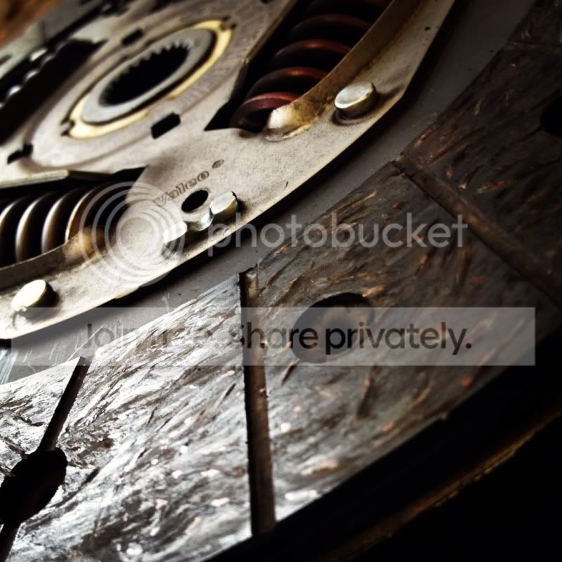

Artsy ass pic of my clutch for fun lol

real quick...i see a pic of the clutch...i saw that you said it had 3:15s...which is the auto's gear. was that a mis-type?
No my car was factory 3.73 and if I had words to describe the wheelspin after the blower I would use them, but I do not. I'm talking THROUGH 3rd into 4th ~80mph on street tires spin city.
I wanted to stay in 4th at the track so I wanted to have my gears take me to ~135 in the top of 4th (optimistic trap speed goal) but I also didn't want to be up against the limiter every pass, and have a little room to grow. I had the gears done at the same time as the tune.
They helped a TON. My car could almost hook 305 wide ET streets from a second gear roll after the gears lol. I hope to get back there soon...

The motor popped about a month ago. It looks quick because I was waiting to have the motor completely disassembled before I made a thread so I could see all the damage and not have some half assed story and just a hole in my block. Then even after I got it apart I was lazy and didn't make the thread right away. I am spoiling you guys with all these pics, I've been waiting on my head for over a week now ( waiting on valves to ship) so trust me the waits are coming lol.

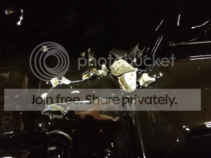

Here is some shit in my oil pan (which has a hole in it btw)
Check out the ring in the oil pump pickup (not funny but funny)
