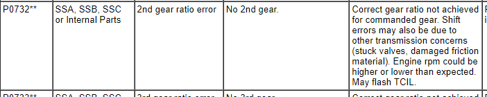

Just this morning i noticed my od light flashing and i lost 2nd gear. After 10 minutes of highway driving i checked the codes and i gave me a P0732.
What could my problem be? I looked it up online but only found stuff relating to the transfluid but since that’s new i dont know where to start.
