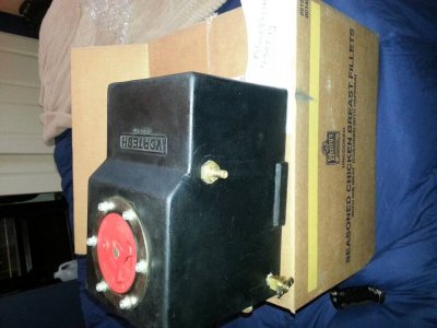

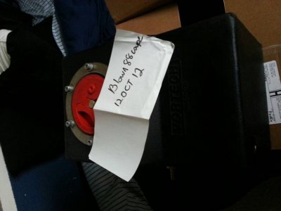

blown88coupe
Dec 7, 2010
640
I have a plastic tank i picked up when i was going to go with a after cooler. Selling it for 100 shipped if you are interested. Pretty sure its fuel safe.
blown88coupe
Dec 7, 2010
640
Sent from my SAMSUNG-SGH-I747 using Tapatalk 2
