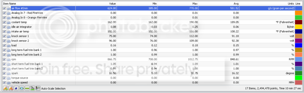

87 Performance at the moment. I did a datalog of the idle and knock sensor one showed a min of 74 and a max of 112. Average was 91.18.
Knock sensor 2 was min 76, max 109, avg 92.38.

IDLE Datalog
Idle%20Datalog_zpsksbry1c9.png~original
ski
Dec 21, 2008
157
Make sure red line is set at 7000 rpm minimum. The throttle plates start closing when the engine reaches approx. 300-400 rpm below red line.
Install a higher octane tune if you have one. And obviously higher octane gas to match.
I'm guessing you're shifting into 4th before the finish line with 3.73's. If so, that's reducing your car's momentum, and also its trap speed.
