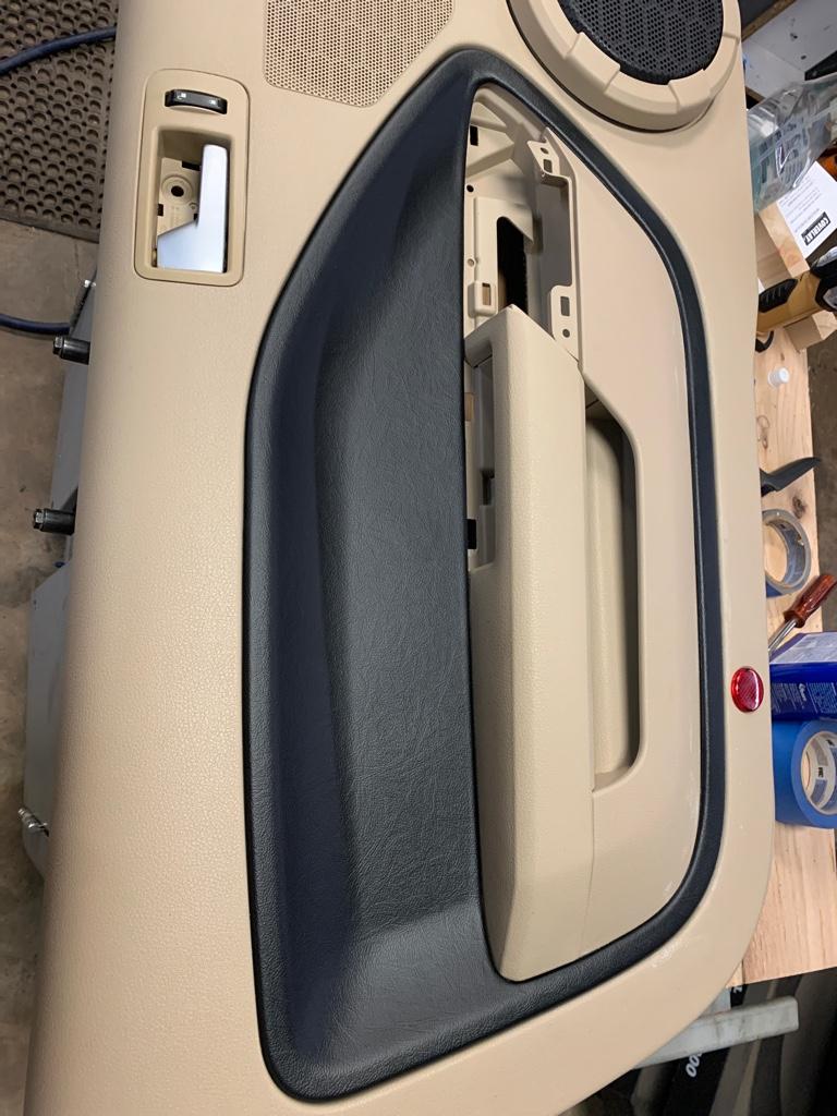

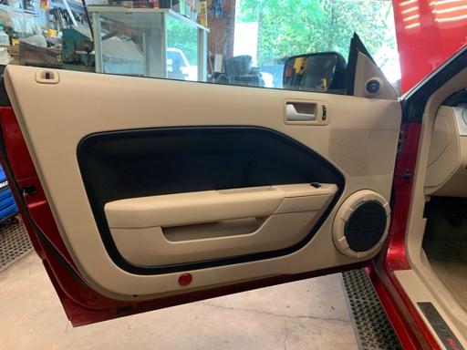

I used the American made Coverlay door panel insert that is all one piece and secures using only silicone adhesive. They look great, just don't have the perforations. I have black doors and used black inserts. Looks great I discovered that you should use more than one tube of adhesive. I'd recommend two or three for each door. Start to finish about four hours.

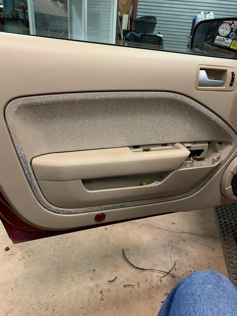

How did you clean up the door panels to prep for new inserts?
Anybody?
jlmotox
Sep 3, 2014
338
36
Anybody?

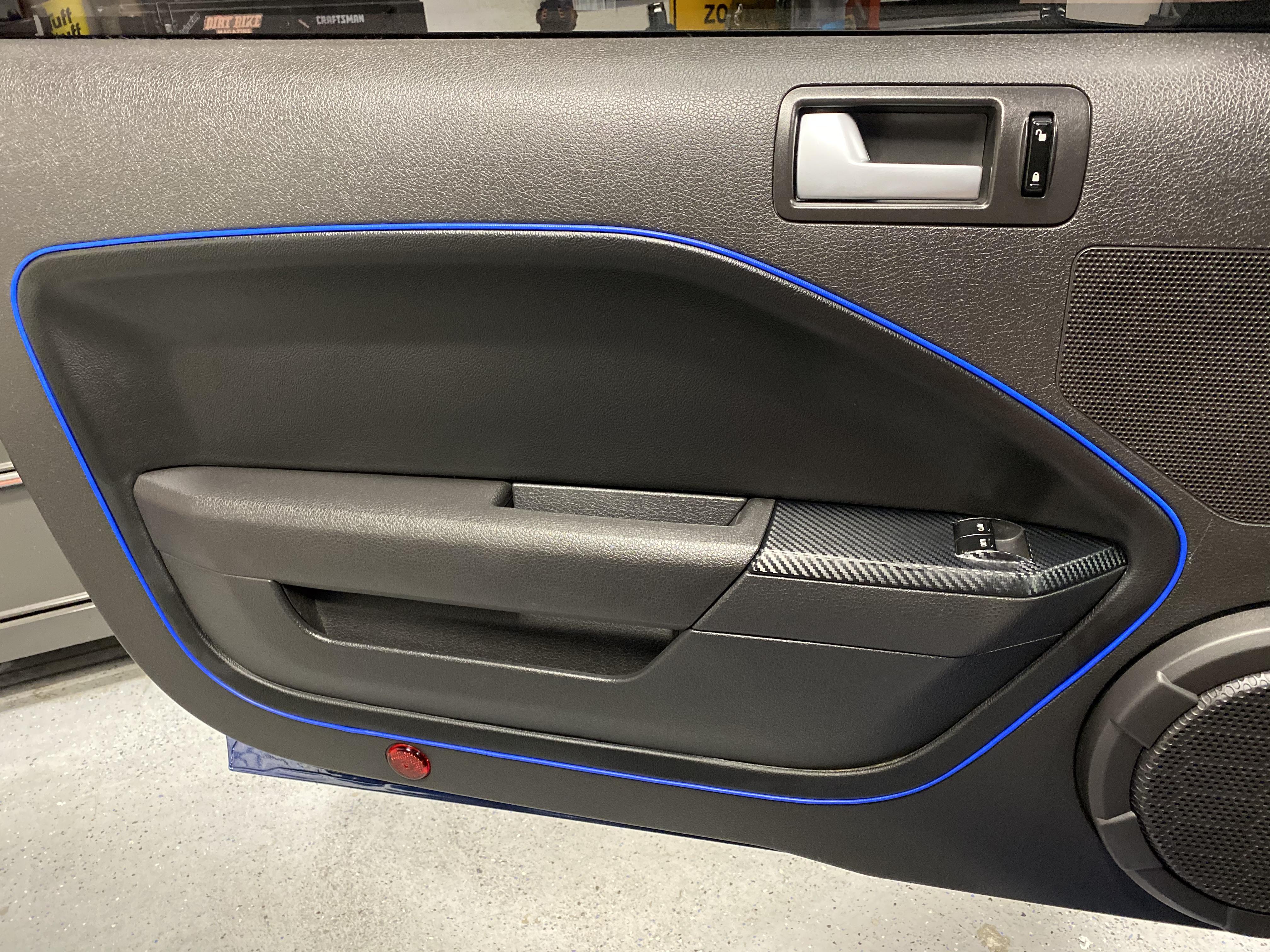

I used a wire brush to clean them up and get as much of the old foam as I could off then I just used the one tube of silicone adhesive that came with it for both and they have held up great! Also used some 1/8” welting pipe to go around the outside.
I did take the door panels off for installation…
