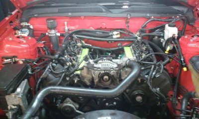

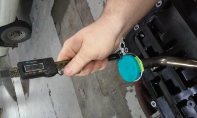

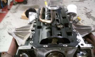

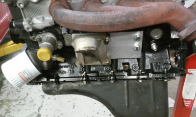

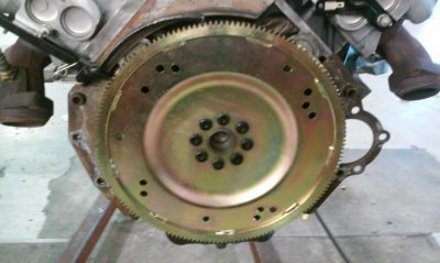

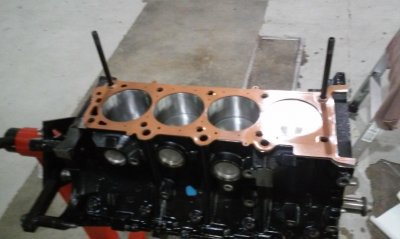

Starting the new build and super excited. Last year on a rod and piston .020 over motor i was able to use a on3 kit and on3 78mm turbo to go 5.83 to the 1/8 @ a best of 119mph. This year id like to thank and welcome aboard the S&H performance crew Bobby and Jeremy as they have sponsored me. We plan to put up some insane track numbers with the twin kit. Gonna be using big bore boss block combo this season as well. Forged stock stroke crank, forged rods ,diamond pistons,arp everything , cometics and total seal rings while displacing 304 ci and 12:1 compression. Re using my heads and custom turbo cams.
