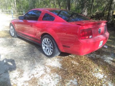

Remember, the S197 does not have adjustable front camber stock. You will need to either add adjustable top camber plates, or a set of adjustable lower camber bolts which replace the stock bolt on each side, they use a cam on the bolt. I went the cheap route and did the lower bolts. It worked perfect, I took the car in to the front end shop for a four wheel alignment. The bolts got mine perfect. It handled like crap before I got the camber fixed.
