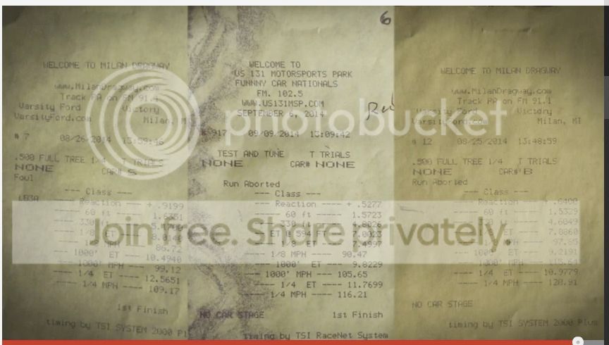

Man... awesome 60' times on factory suspension.
Ford is gonna sell a lot of the upgraded half shafts.
The real thing to take from that is the upgraded rear sub frame they put on. All three models had it. Which one is the weaker point? The half shafts or the sub frame? Most guys will go straight for axles I feel, leaving the sub frame. Or leaving both stock, throwing on some sticky tires and cracking the sub frame. That wouldn't be a cheap or easy repair. I feel that if they took the time to upgrade it, it will be a necessary mod for the track and hooking and setting those 60' times safely.

So a 12.58 with only a tune and exhaust as far as HP mods go. Not bad.
