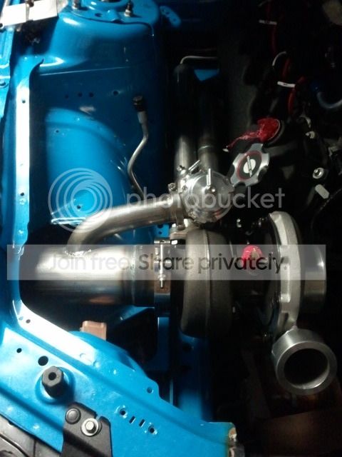

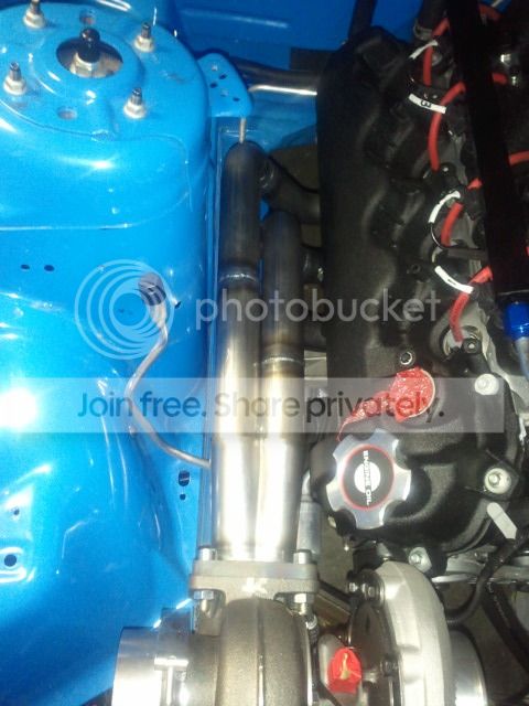

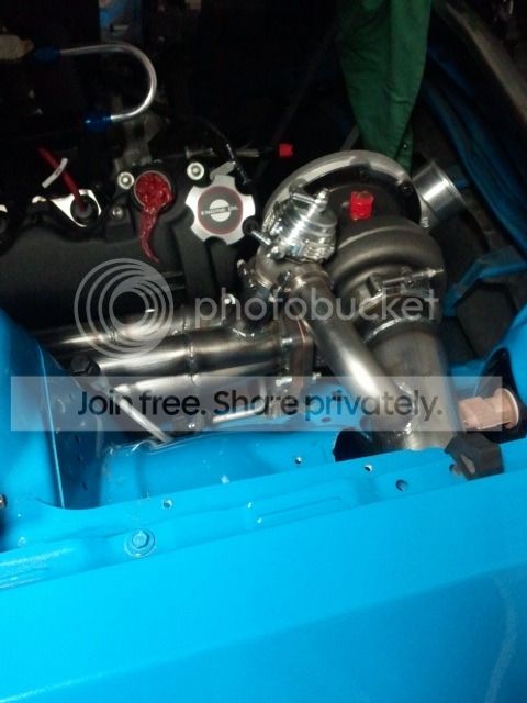

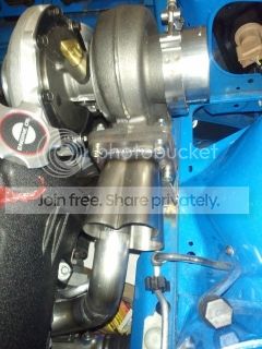

I thought I would share some pics of my new setup. I'm running twin BW s366 turbos and I am building some forward facing headers that go up next to the valve covers similar to the ls forward facing headers. I was able to reroute the high side (smaller) a/c line by bending it a little and I'll be getting a custom suction (larger) a/c line since the stock one would be in the way.

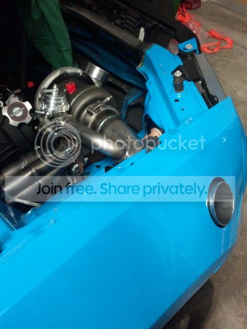

Now if you notice the downpipes will be exiting the fenders like Silverpoison did, because this car is mainly a race car, but still able to be driven on the street. However, I'm sure someone with some ingenuity could weld v-bands to the headers and put the turbos elsewhere to allow for rear exit downpipes. I won't be selling these since I am just a guy building his car, but I figured it might give others who could sell these some ideas to maybe make some headers that retain a/c and power steering(although I deleted mine for looks).
I'll share more info and post more pics as it progresses, but hopefully I'll have the turbo setup built in a week or so.

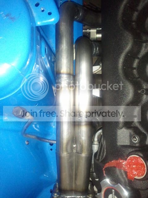

More pics of passenger side header built and tubes welded. I still have to weld the primaries together in the collector and weld the collector and head flanges on. I'll be using a junk head for that to keep the header from warping while welding.

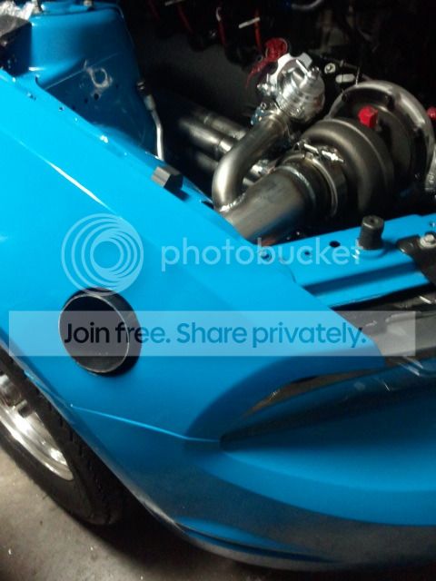

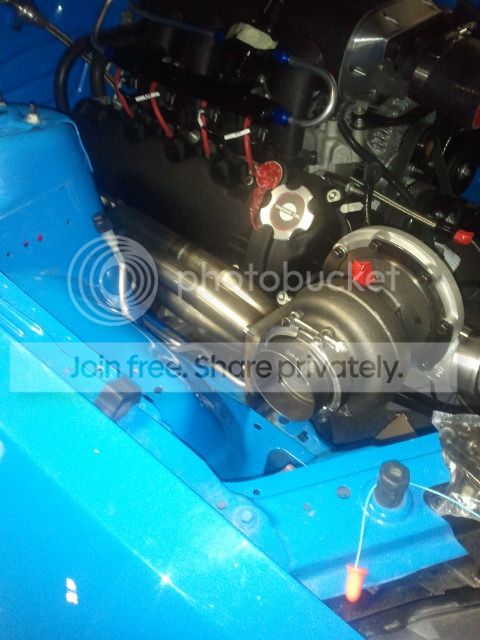

Some more pics. The downpipe is finished on this side. I need to square up the cut where it exits the fender and get some trim rings.
