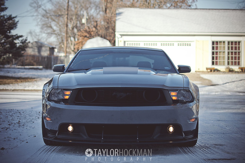

With your current mods, I think you will either be in CAM or STU. Beyond those, it's ESP. Someone correct me if I'm wrong, but I think the front splitter may force ESP is someone wants to be a dick and protest. If you just want to play around, and not worry too much right now CAM is probably a good place to hide out.
If the splitter is the boss LS one, he's good to go. If not, the asinine new CAM arro rules push it out and straight to SM

It's the FRPP World Challenge splitter. Smaller then the Leguna Seca.
Size is only part of the problem. The areo rules for ESP say that the splitter can not extend past the stock shape of the body at it's widest points as viewed from above. The only reason the LS splitter is allowed in ESP is because it was a stock factory part on a model of Mustang classed on the same line (verbiage may be a little off, but that is the meat and potatoes of it)
Good to know. I've gone over those rules a few times, and am looking at the 2015 draft again. I'm waffling between a Boss splitter setup or the Stillen (nee Street Scene) one--the one without turnbuckles. I like how the latter looks, but I know the Ford part is setup to take the LS functional splitter.

Yeah it would, but if you can show me someone at the regional level who would care, I'll call him a dick for you. (Phrasing?)

Unless you are taking first by a hair at every event, then second will probably say something. My take on it is this. I follow the rules, it is just how I am wired. If you have something that clearly doesn't give you an extra advantage, or you are not running at the highest level than I really don't care what you do. Just be aware, you are outside of the rules and if someone protests you then you really can't complain. After all even if the rules make no sense to you or anyone else, they are what they are.

Yep. Per 14.2.F you are not technically legal for ST (it's not a production part but a performance catalog part). To me it looks fine for SP. That said, the LS splitter--which is legal due to being a standard part on the Boss 302 LS--is bigger. I wouldn't protest it, and if someone does, it's a dick move. Personally I'd just run it and if someone does pull the dick move, then cross that bridge then.

I'll run it and see how it goes. I still have my stock BOSS splitter I can throw on if I need to. But taking off this WC splitter just sounds like a PITA. I purchased this mostly for the aggressive appearance. Wasn't too serious about tracking the car at the time.
