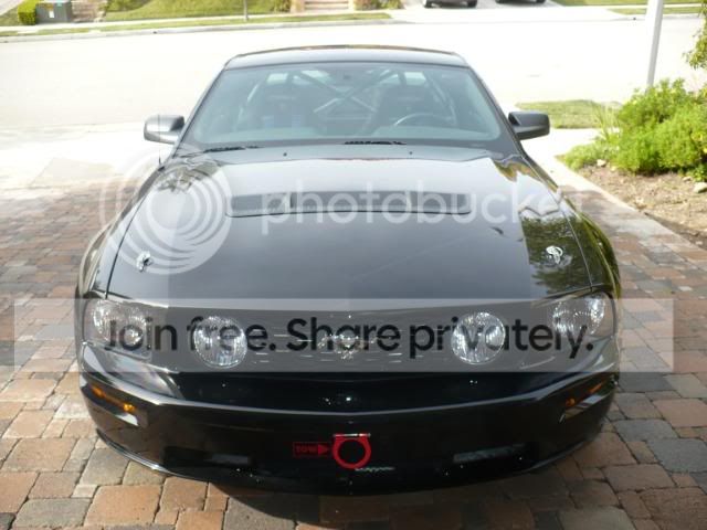

A few guys have installed the 2010 GT500 outlet to the 05-09 cars.

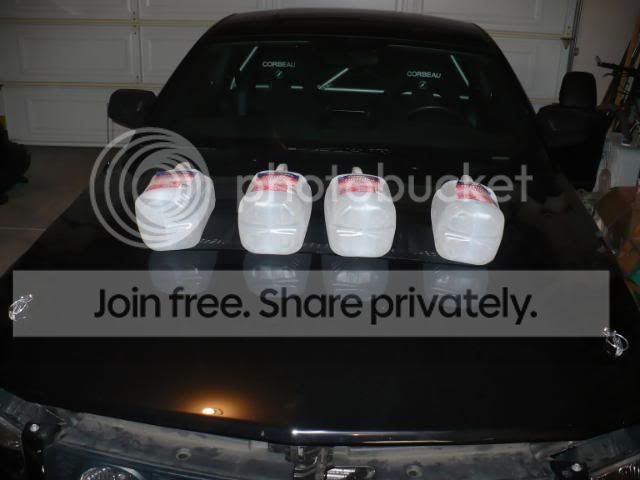

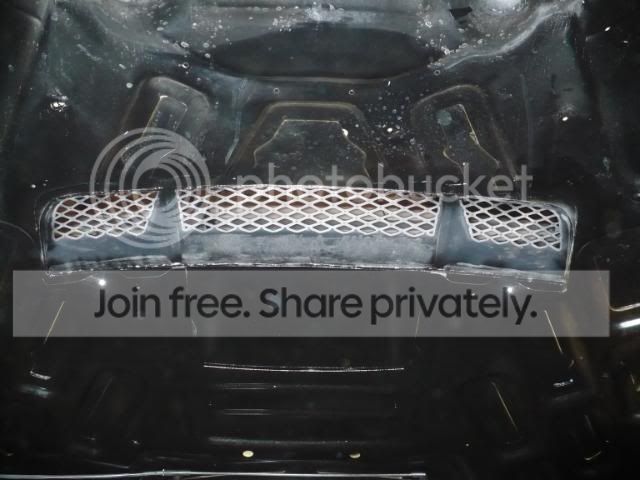

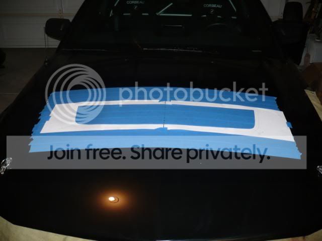

Oh mama, I did it. Finally cut into the hood and installed the GT500 vent. After prepping the vent with the dremel and belt sander, I made a paper template and centered it up. Then centered it up again. And again.
I used 3M urethane windshield adhesive to stick it in place, weighted it overnight, and so far it has held up just fine around town and on track with no sign of expansion/contraction related warpage. I'll post an update if it flies off.
And the obligatory post-whore track picture:
The surprise tech for me was that I am now seeing a consistent 10-15 deg F reduction in temperatures. The hood vent was the only change made. I didn't go over 200 deg F on the track--a very nice surprise for a $45 modification. Thanks to the guys on cornercarvers.com for first doing this.
