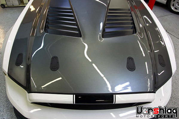

We installed this Seibon S197 "GT500" hood for a customer and it fit a little better but it was by no means perfect. This "carbon" hood was a layer of carbon over a relatively heavy fiberglass hood - like most of the "carbon" hoods you see for sale for these cars.

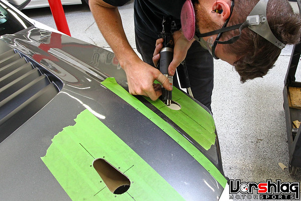

We used this hood because we felt it had the hood venting more properly placed than the Tiger hood - where it could extract from behind the radiator and not all the way at the middle to back of the hood (which has higher pressure).
Of course we cut out the small-ish GT500 opening and tripled the cut opening size, then added a louvered vent. All in all it fit pretty well for a $1200 hood. The right way to finish this still takes sanding and paint but the customer wanted to keep it the carbon fiber finish. Its not as light as the Tiger hood, but it also hasn't cracked in over 18 months of use.
Personally I like the OEM aluminum hoods on the 2005-14 S197 cars. We can work with these and get them vented properly and they are no heavier than most of the aftermarket composite hoods. But I get it - the Tiger hood looks cool and everyone loves it. :)
