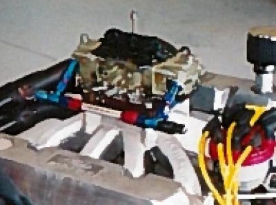

Phenolic has been used for decades for carb spacers. I've run them. They don't absorb water. There may be slightly better materials but phenolic certainly works at a reasonable cost.

I just noticed my avatar pic. That motor was from my super late model asphalt race car. Whats that brown thing between the carb and intake ????
