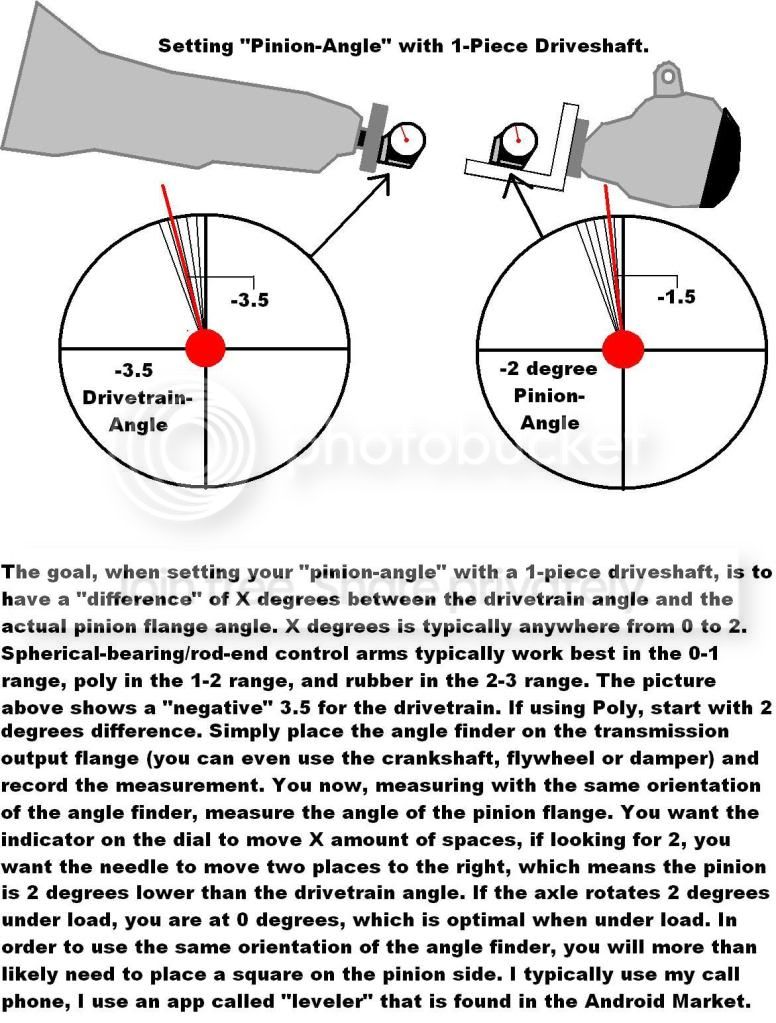

Here is a picture I recently drew for someone. Hope this helps!
I thought if the rear end or for that matter any section was up, that was a positive reading? only if it was pointing down would it be negative.
So -3.5 + +1.5 = -2 correct
