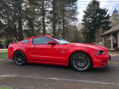

Just a question, what angle did you reset 2 degrees?
I've lowered 4 other 11/14 Mustangs and never changed any angle, not even the alignment.old Mustang1.jpg
