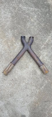

20210417_141456.jpg Here's what I ended up with. I ran as much straight pipe as possible from the collectors before turning for x-pipe tie-in. Dyno proved a decent addition of torque with that 18"of straight over bending early. I just pulled this crossover and LT's off the car to put the stock manifolds back on for a turbo install. Which will be for sale btw.

If they’re for sale then let me know. I can give you my phone number or whatever you prefer if you want
I didn't realize I didn't attach the picture to that post. Edit is in. You probably can't pm yet. Not enough posts. I'll figure something out.
