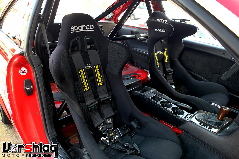

Terry started using the Schroth harnesses at my request. Their combination of belt material and latches made for the easiest adjustment, and ability to get them tighter, easier. And they made some custom combinations for us to fit some specific seat and car setups that their off-the-shelf belts didn't fit.
Though I'm NOT a fan of using 4-point belts on track, and won't put them in any of my personal cars, I've had customers that loved them. And Schroth's tech on the subject is sound. But, the mounting has to be accurate for it to work, which means that you have to consider seat position and belt routing when installing the seat. I'd rather use the stock 3-point for street use and a 6-point for track use.
