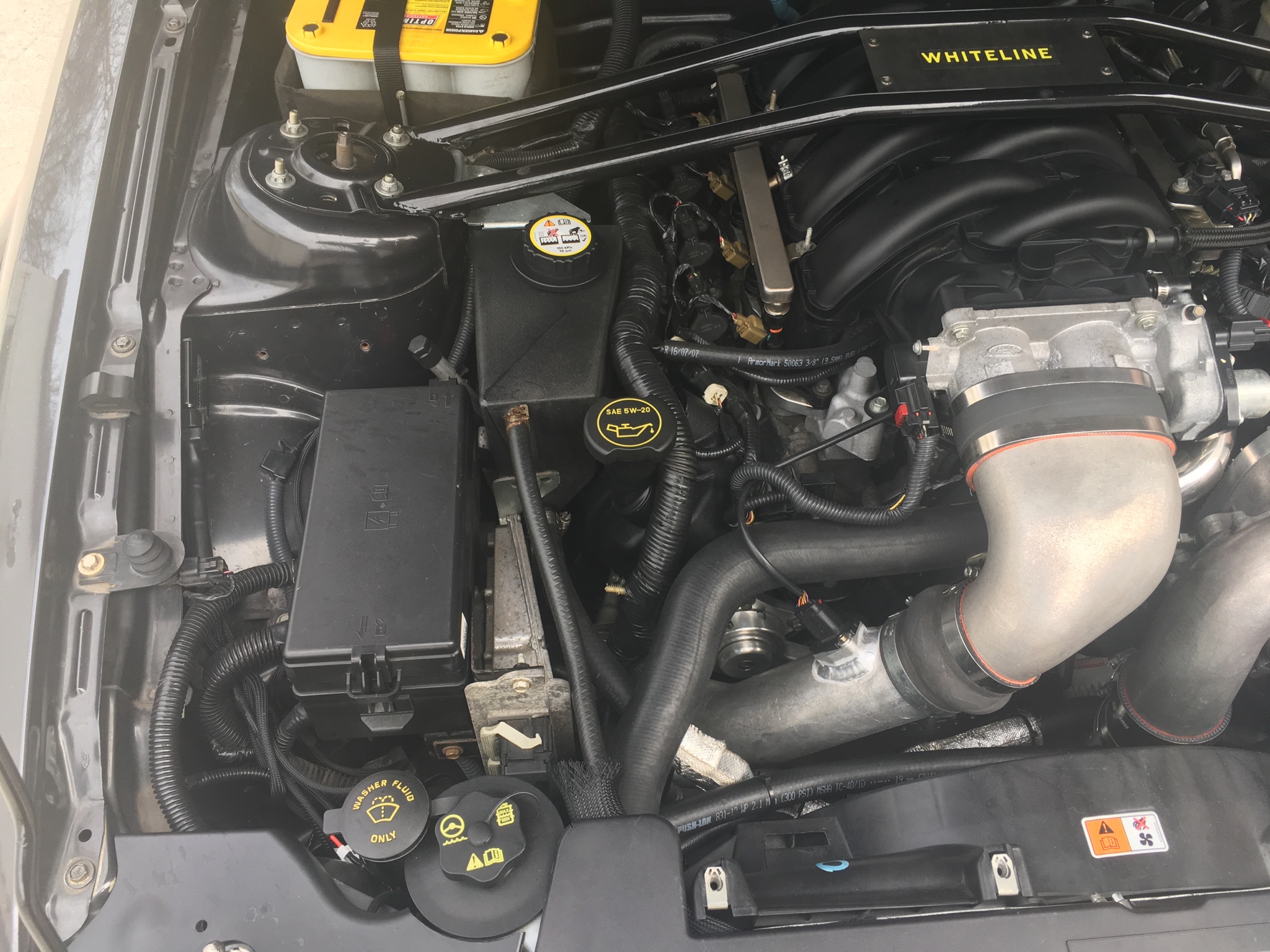

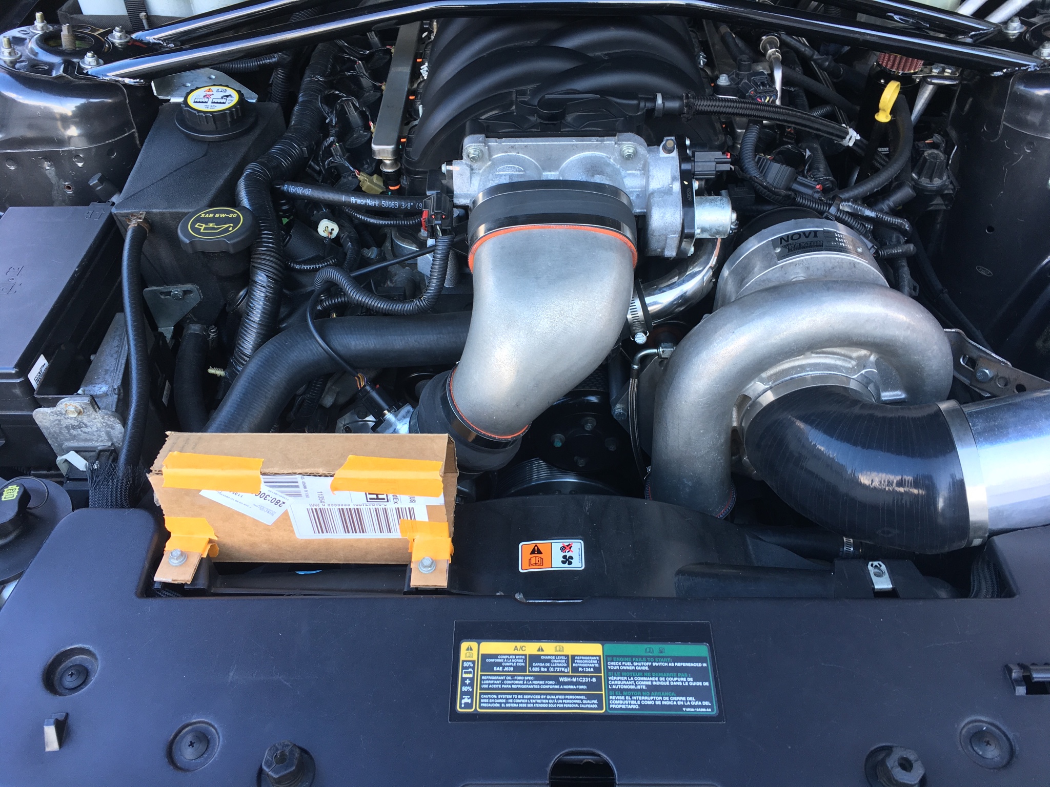

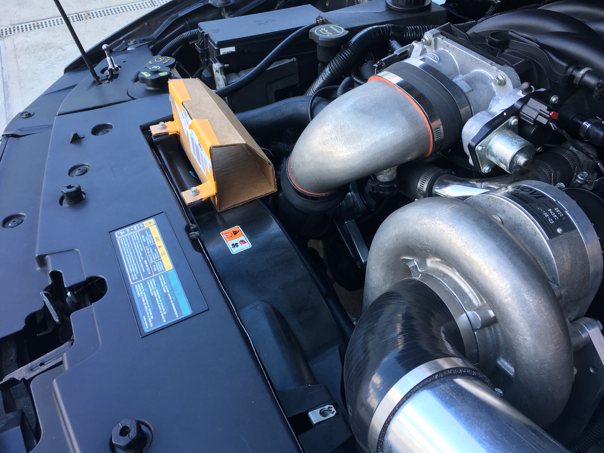

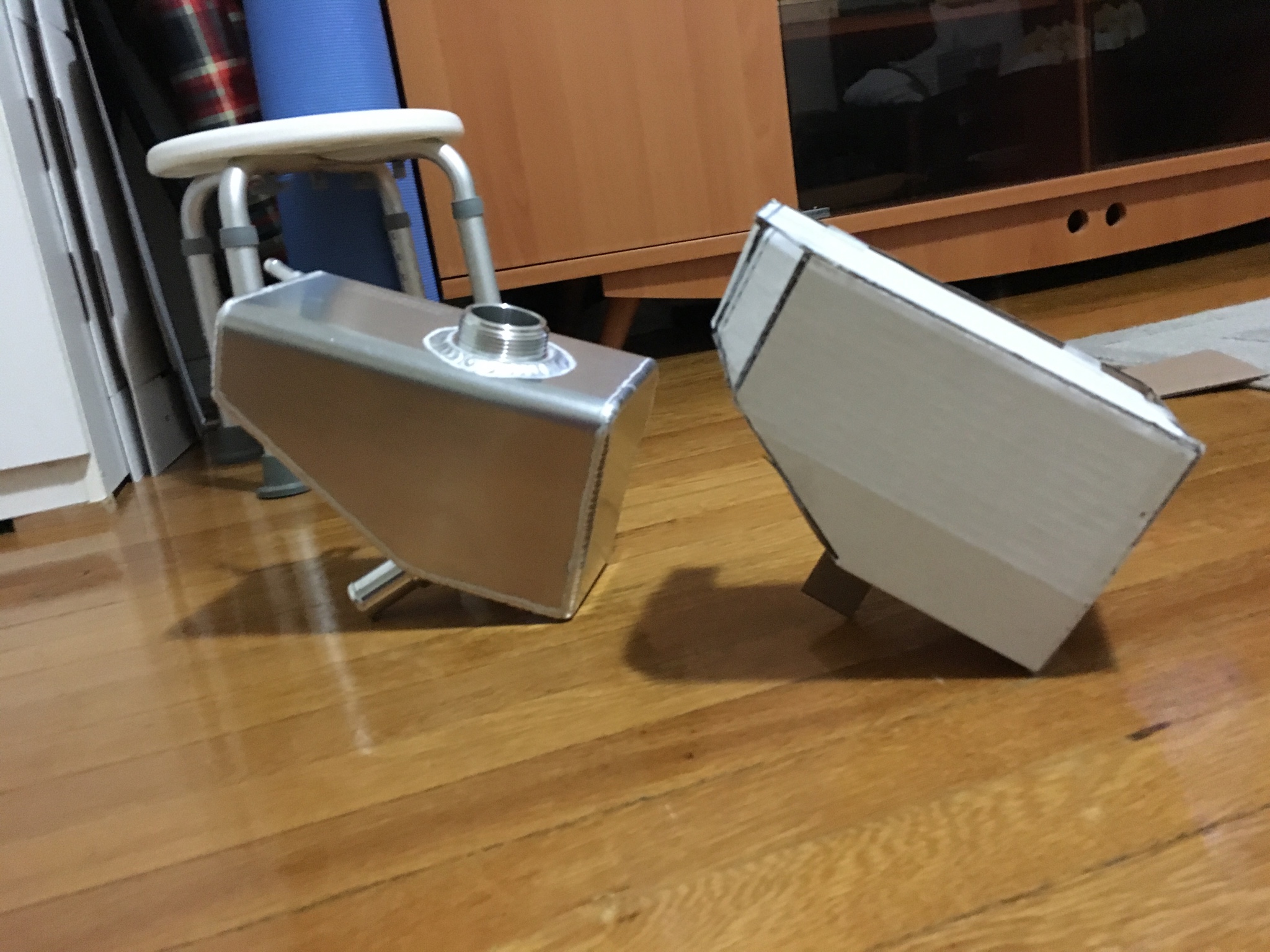

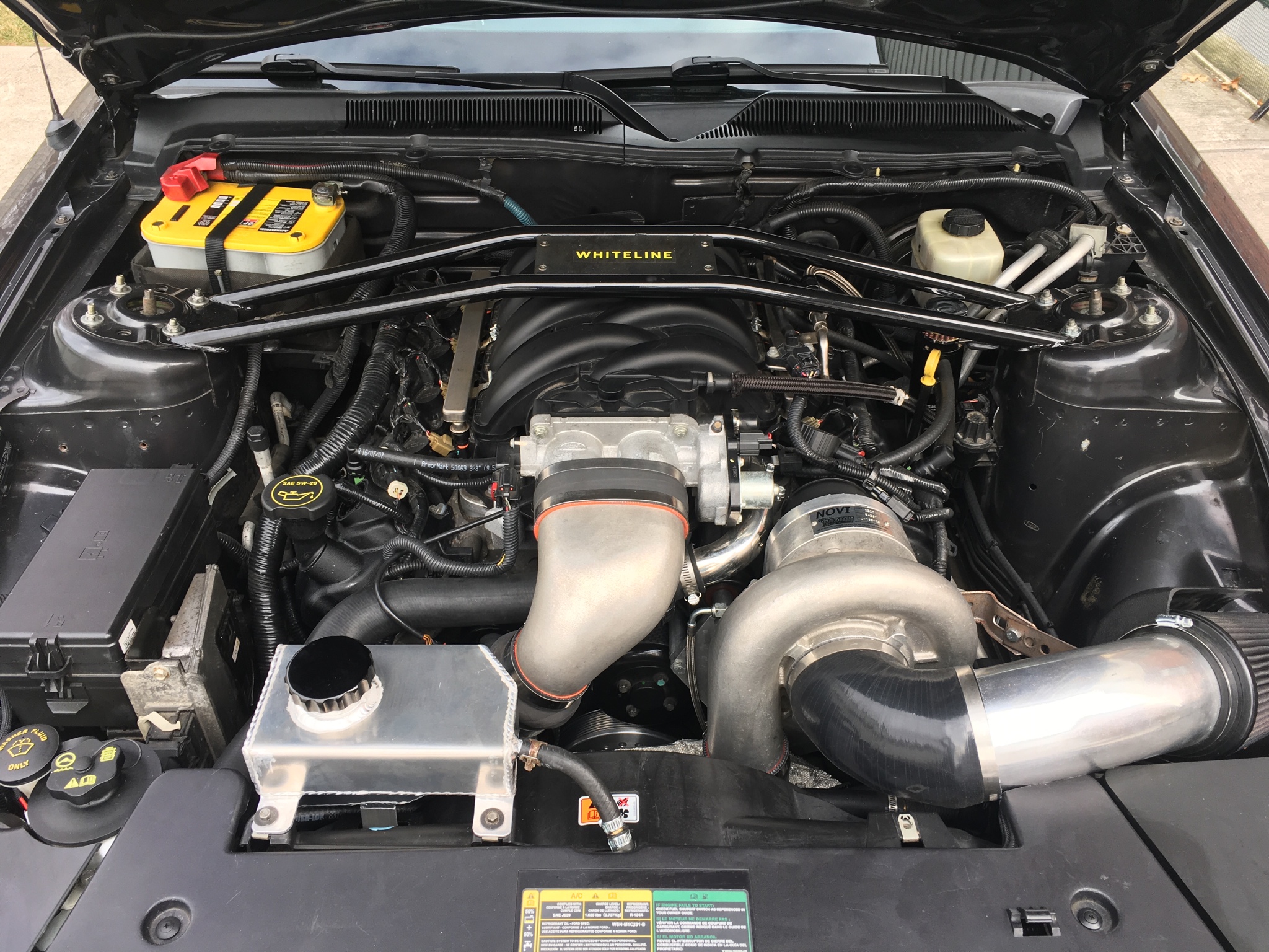

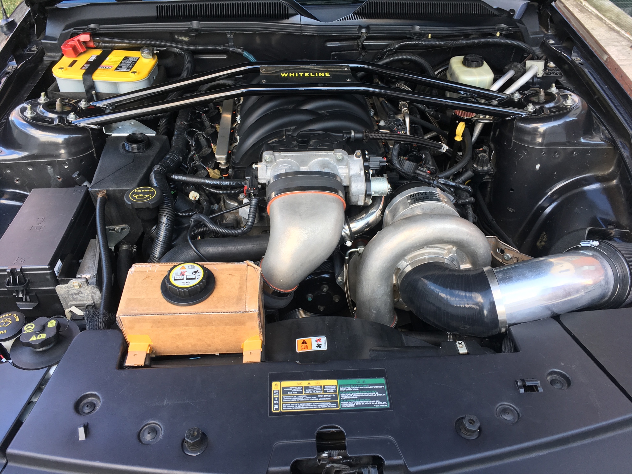

Ok I moved the top of radiator about 1" forward by drilling new holes which gave me some good clearance. Here is a mock up, let me know which one you guys like more.
Version 1:
Version 2 (I obviously put a little more effort on this one lol):

Personally I like the second one best of the two, but I also dont think you are going to gain anything temp wise by moving it.
I have no problems with temp honestly. It's more just cosmetic reasons.

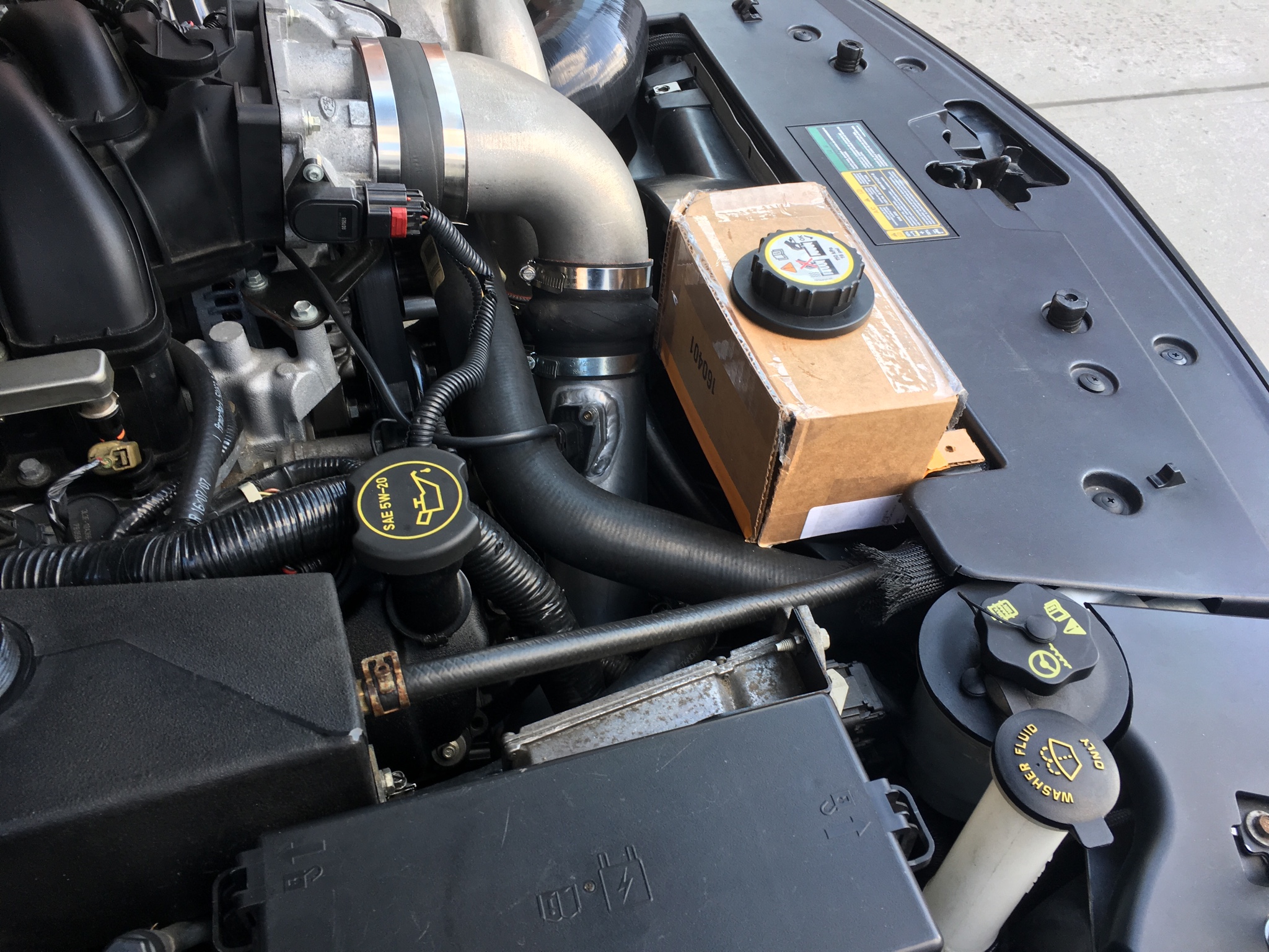

I like the 2nd one. It looks like it'd hit the hood when closed though. Could just be the angle of the photo.

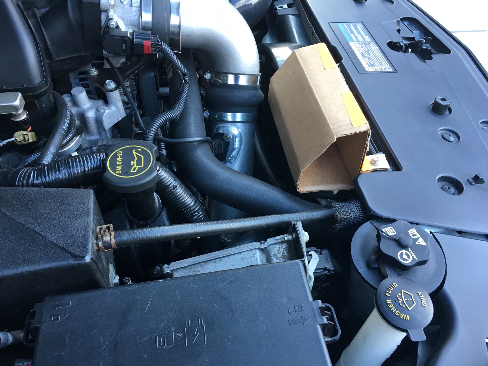

Hood closes, the box didn't collapse but it wasn't secured in place either so I dunno.
groundpounder
Aug 9, 2011
145
Try placing a piece of chewed gum, modeling clay, playdough, silly putty, etc., on the tank cap then close the hood. If it sticks to the hood then you have a clearance issue. Do the same to the tank in a couple spots just to make sure everything clears.

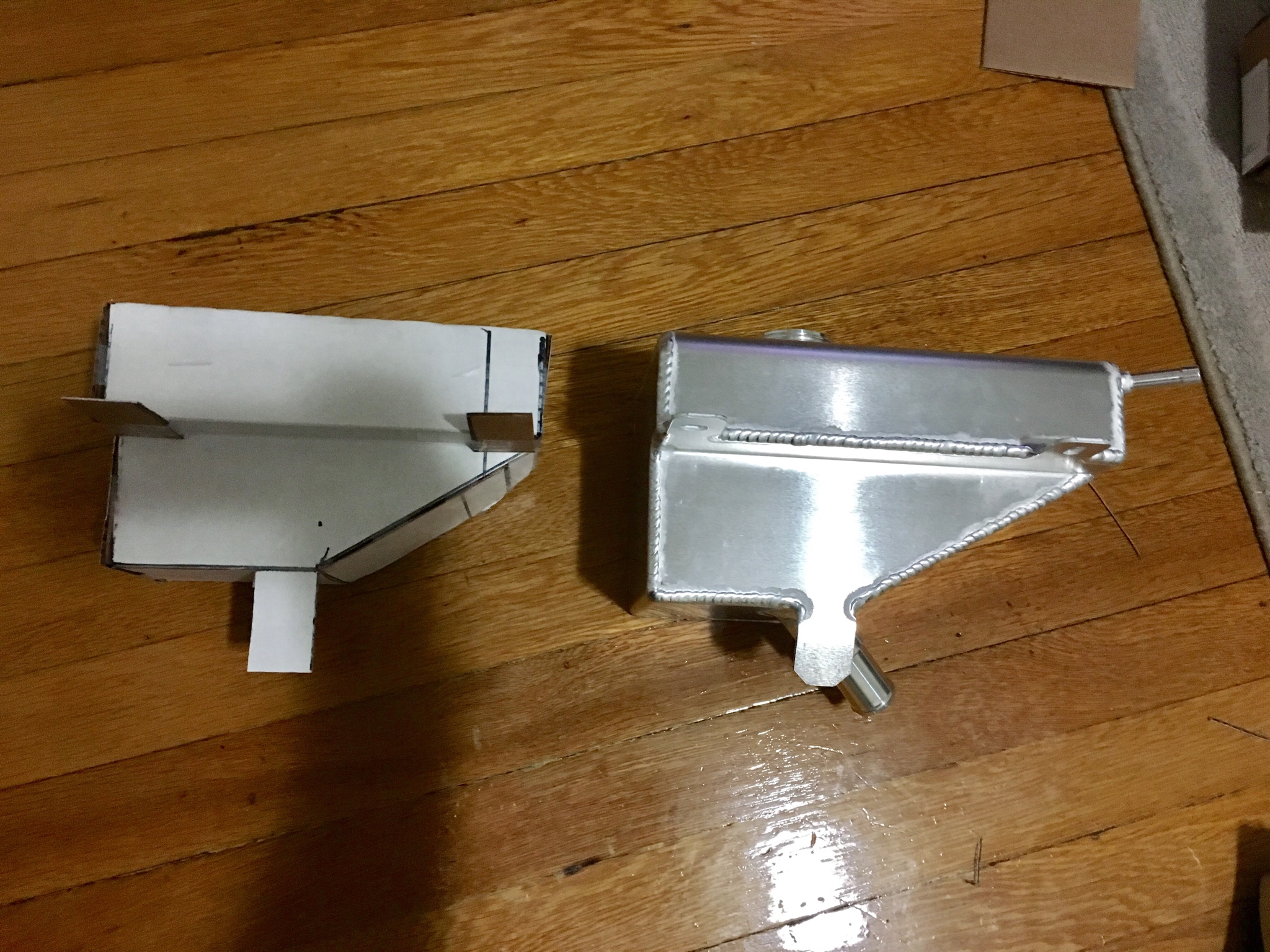

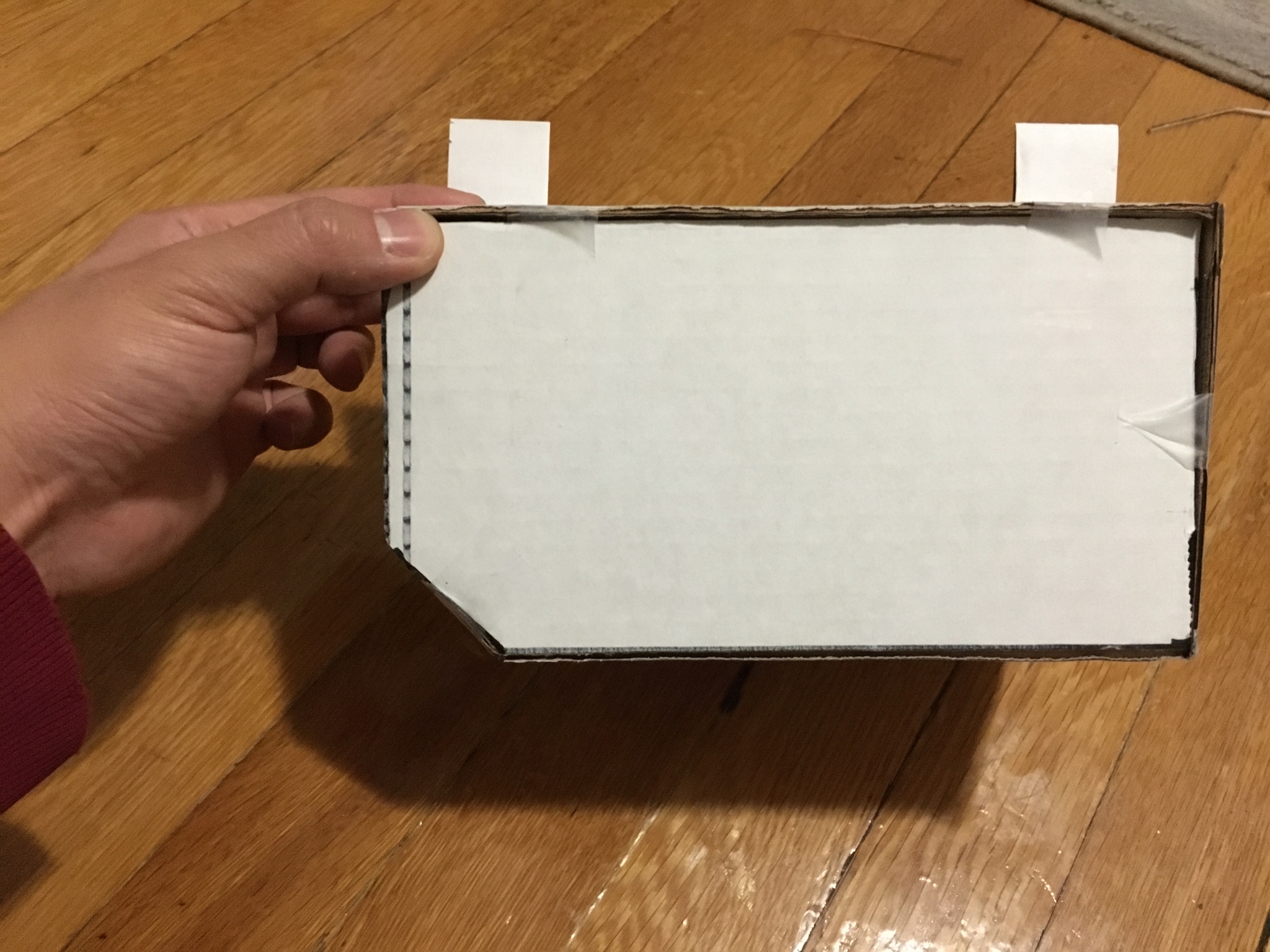

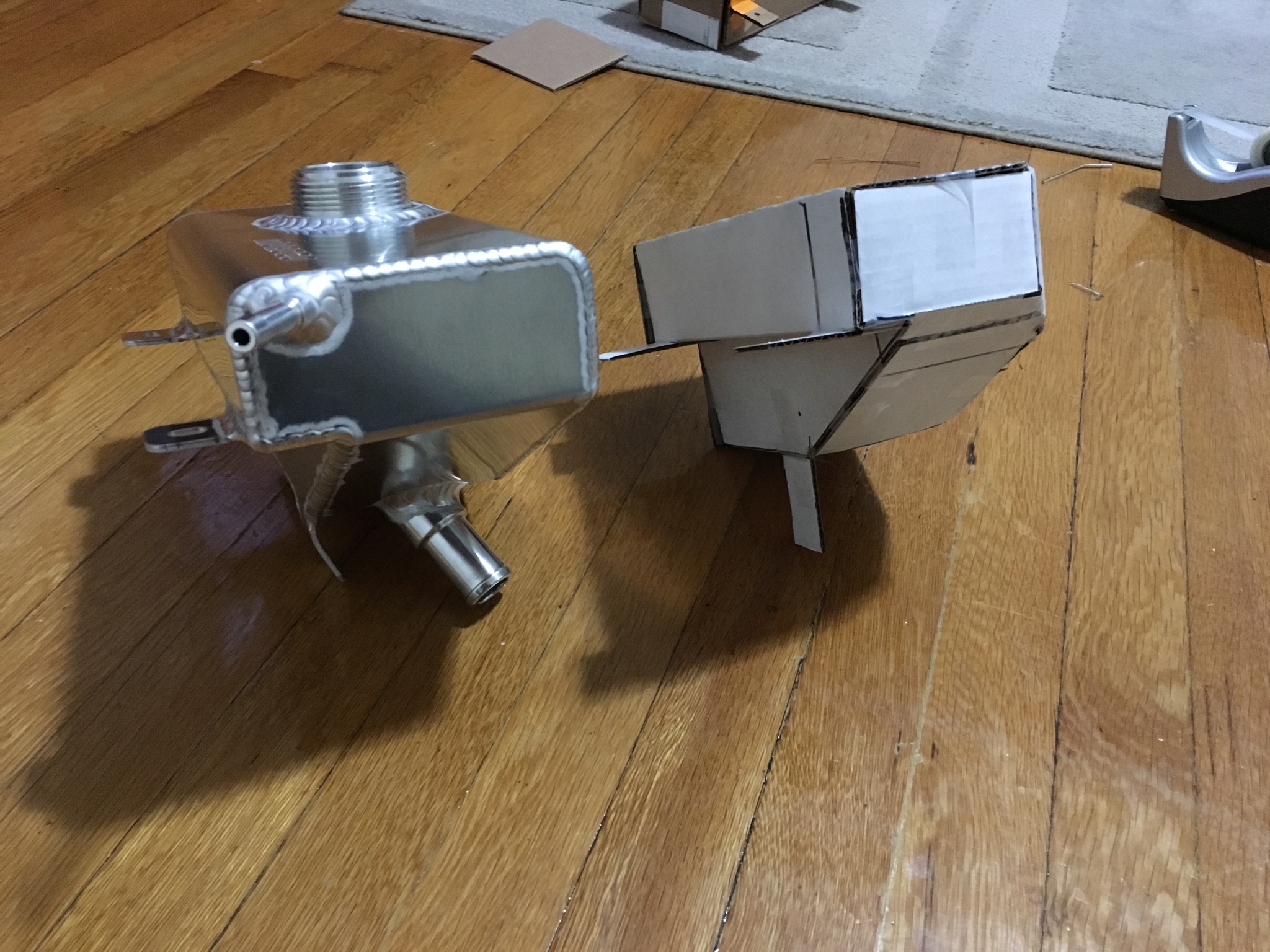

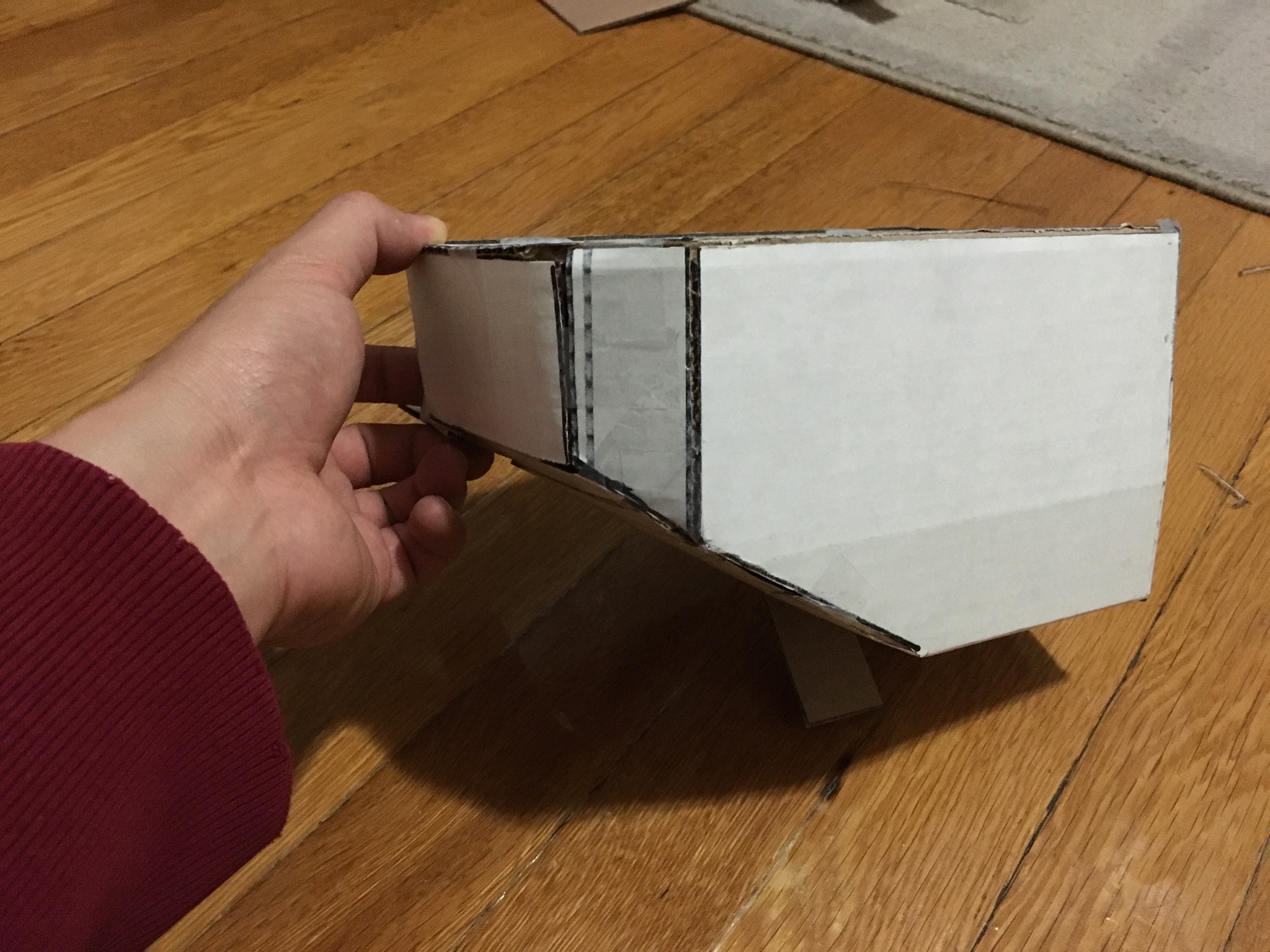

Ok here is Version 3. Basically 20-30% smaller version of the Moroso plus the needed clearance by the throttle elbow.
Key area for elbow clearance:

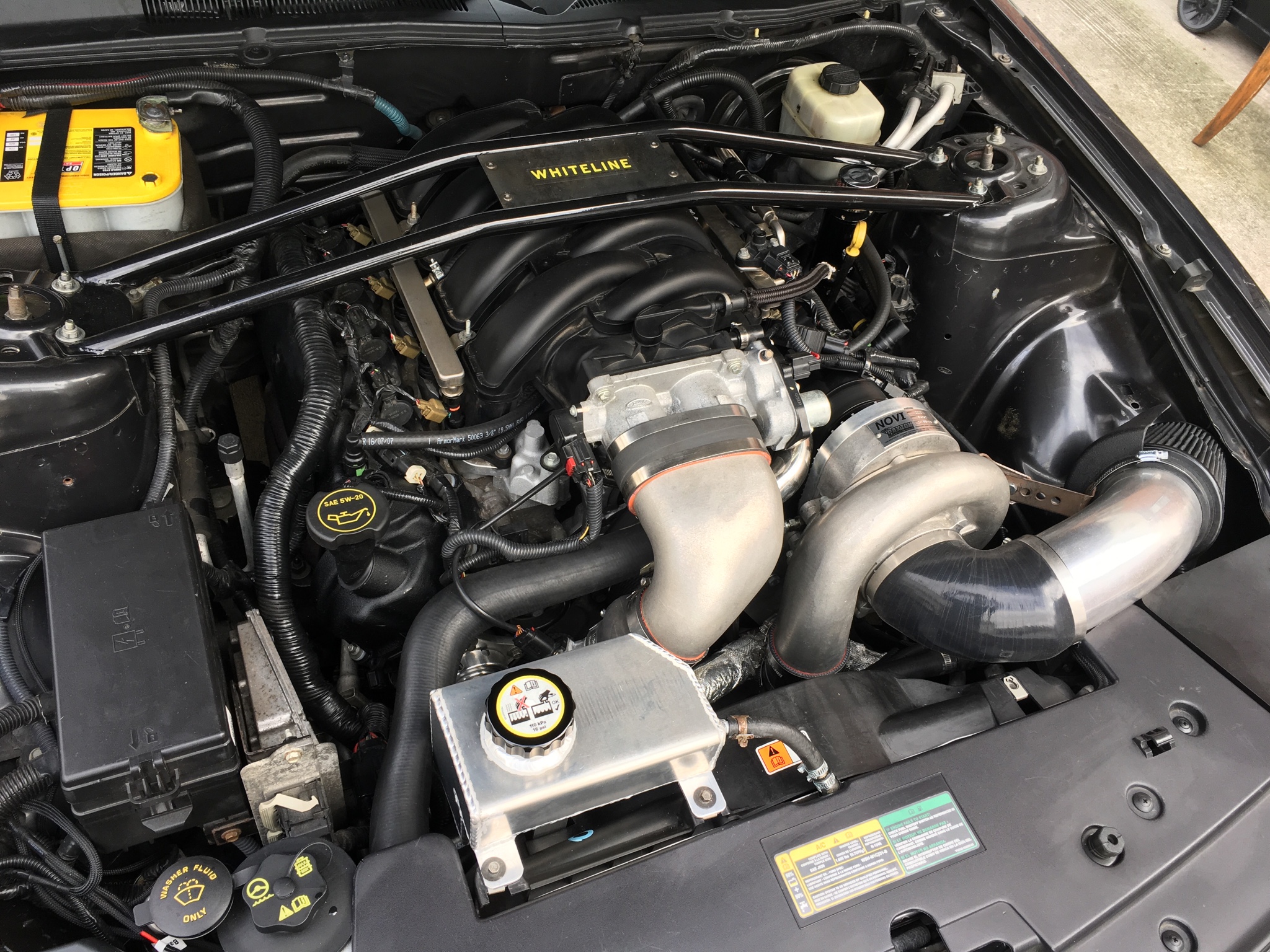

It's finally here!!! Can't wait to install this tomorrow:
groundpounder
Aug 9, 2011
145
Looks awesome. There is nothing like having a part custom made. Gets you exactly what you want.

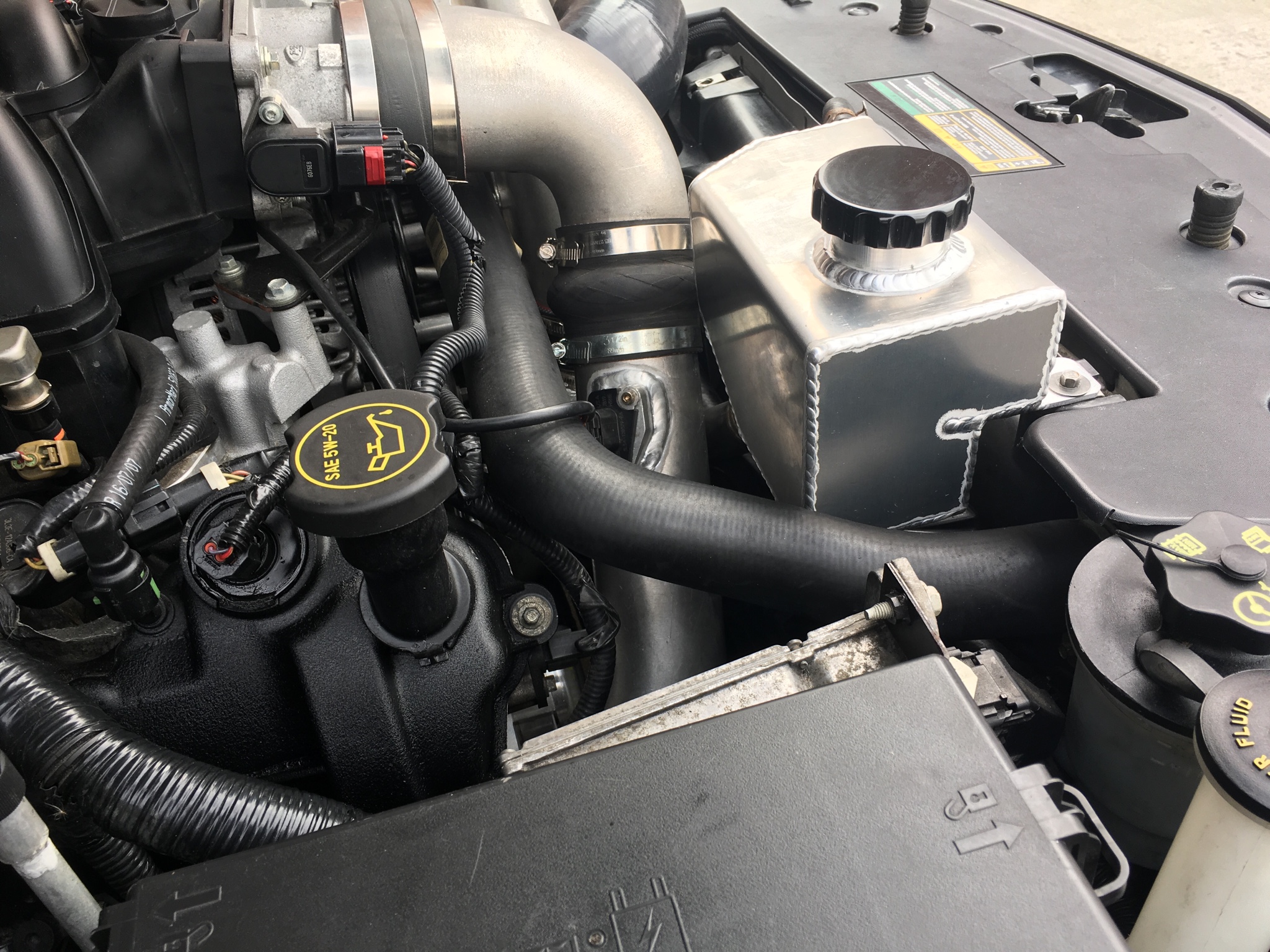

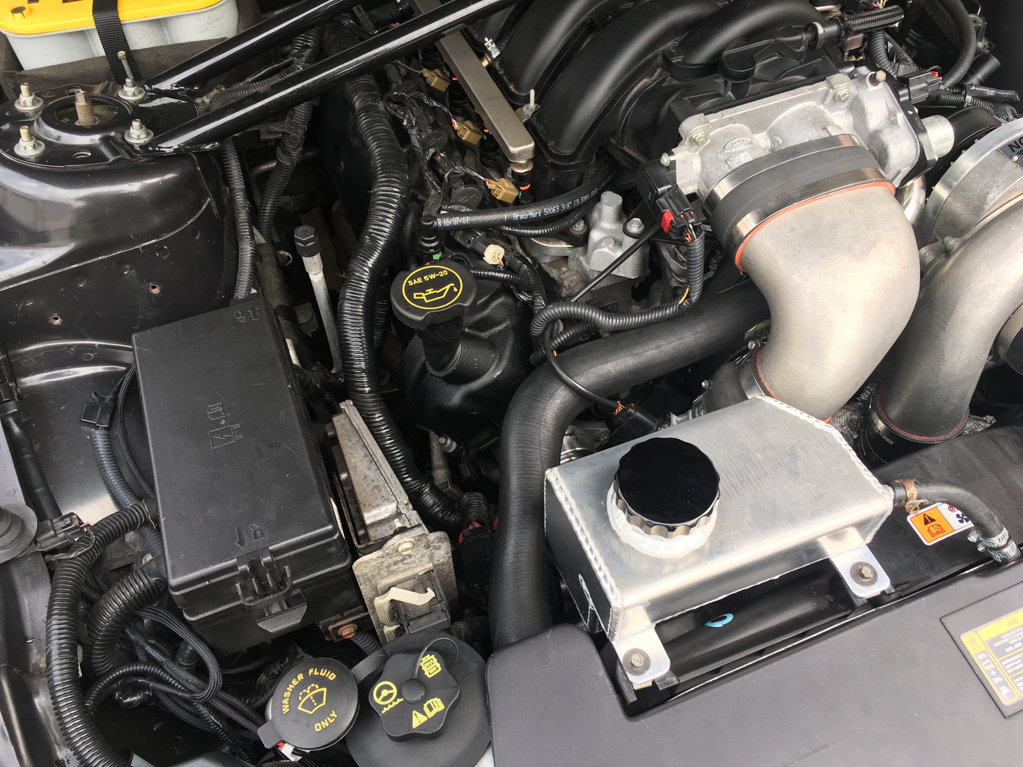

They look good now. I guess when I looked at them they were huge. When are you installing you new jewelry????

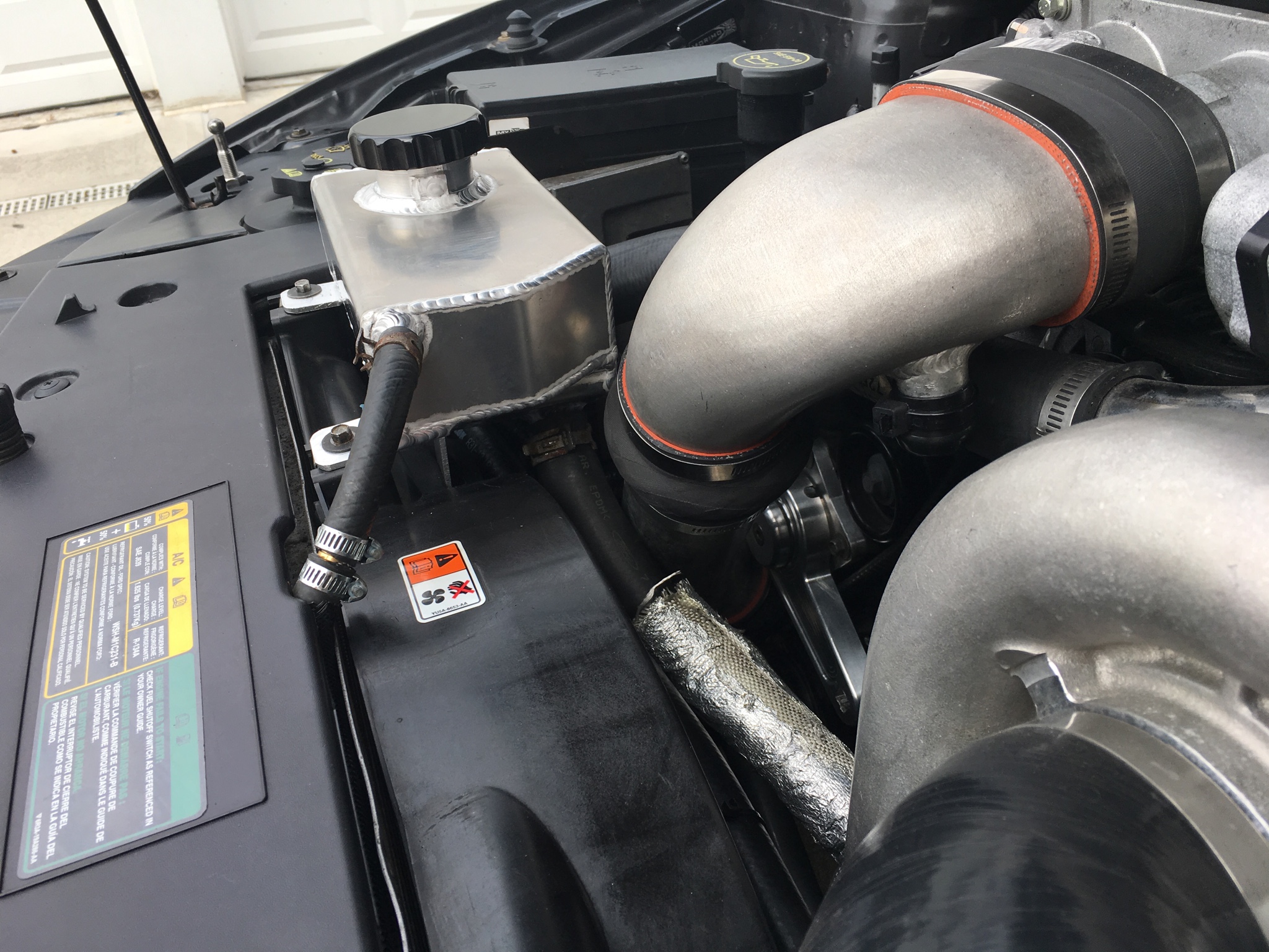

Today!

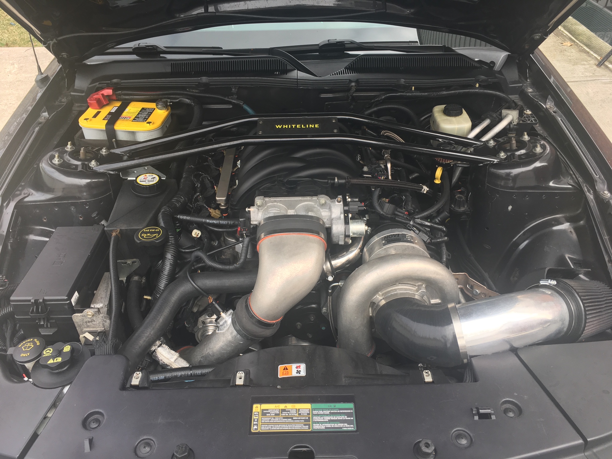

Before:
After:
And the finishing touch, peeled the sticker off the OEM cap and reapplied.

Yes the top has been tilted forward good 1/2-1". Did this by drilling new holes to the upper brackets.
Tank was $150.
