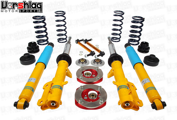

Did they throw in a set of sway bar end-links to make the picture looks cooler or something?

Ok thanks guys. I know someone mentioned something about volshlag I believe and its bilstein coils. So probably going to save for those and I'll probably go with some shocks and struts for now since my stocks are worn out.
Save your pennies and get something good to start with. That's my advice...
http://www.vorshlag.com/product_info.php?cPath=340&products_id=790
So many folks go down the same route where they do this:
1. Buy lowering springs + twin tubes. Looks bitchin, rides like ass, blows out the struts in 3 months.
2. Upgrade to cheap coilovers. Sits even lower, rides even worse.
3. Then upgrade to GOOD coilovers. Ahh.... now they did it right, and lap times drop. Proper suspension travel, real monotubes, with quality components front to back.
This is literally how 90% of Mustang folks do it - a multi-year journey of pain and spending before they find something good. And what do they always tell us?
"I wish I just would have bought these coilovers from you first!"
Don't be like Peaked in High School Rob Lowe... get good coilovers the first time.
