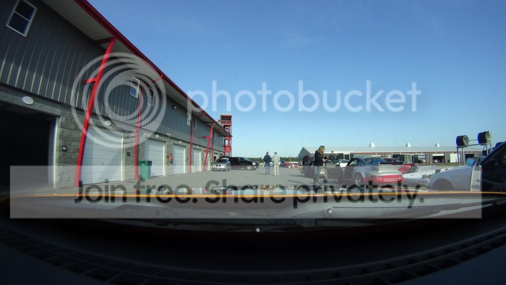

My first track day was yesterday at NJMP with Hooked On Driving..
picked up a set of hoosier continentals scrubs .. I love the price on theses 275 x 35 x 18 mounted on american wheels .. best bag for the buck wheels out there, and look killer too 18 x 10 all round
Day went good till the shifter messed with my day basically could only get up to 3 gear and had to drive the track that way for the full session .. after 3 sessions that way I called it quits but the car performed great despite having 113 on the clock and running at 6200 Rpm most of the day in third..
Arrived at mellville NJ the day before
