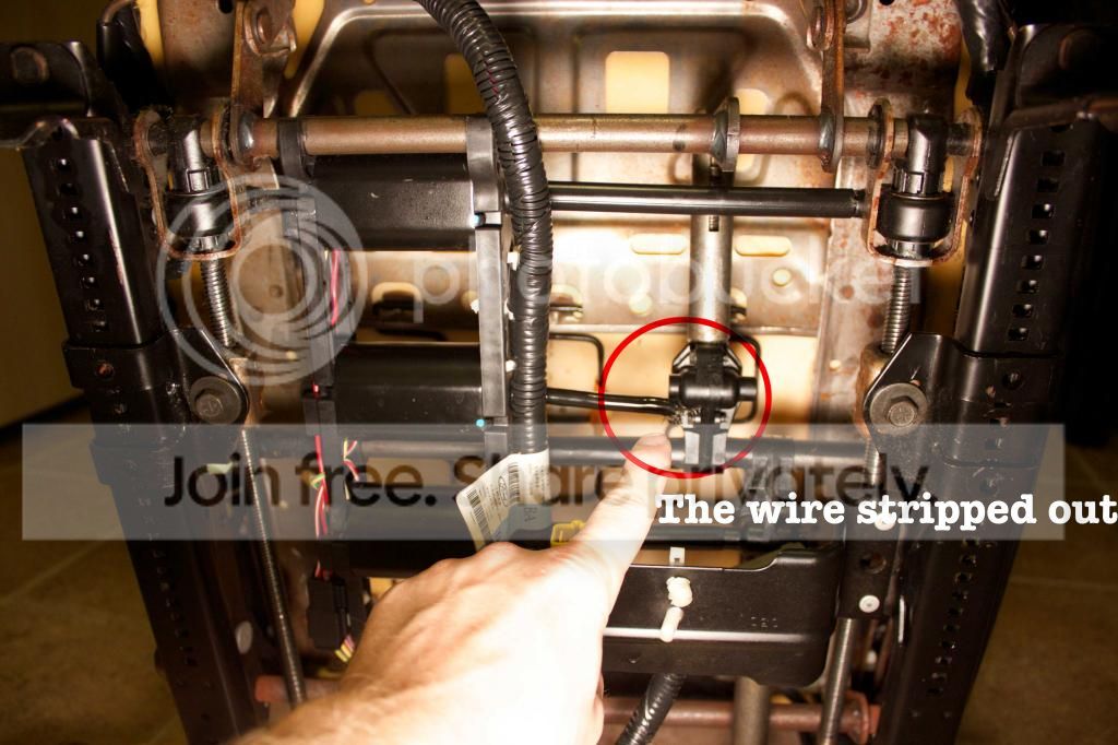

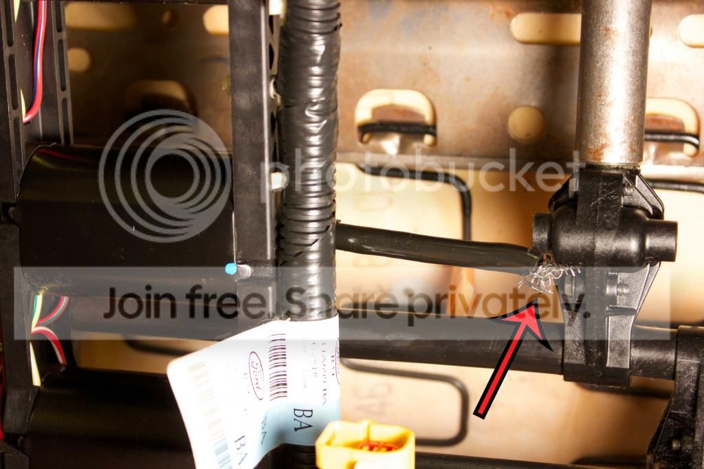

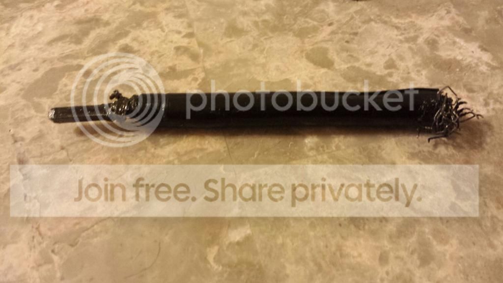

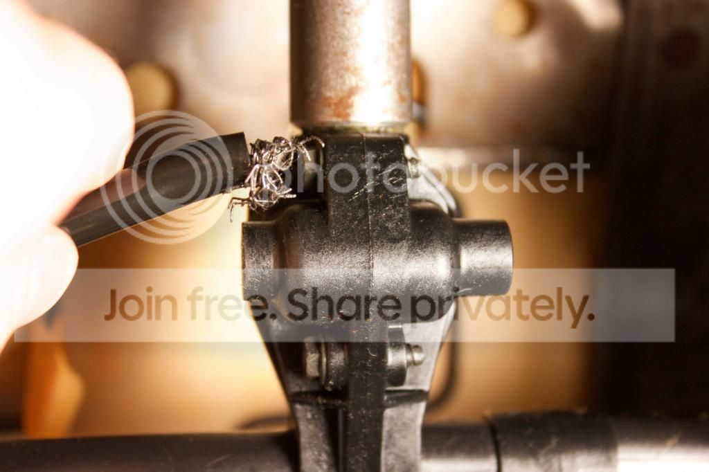

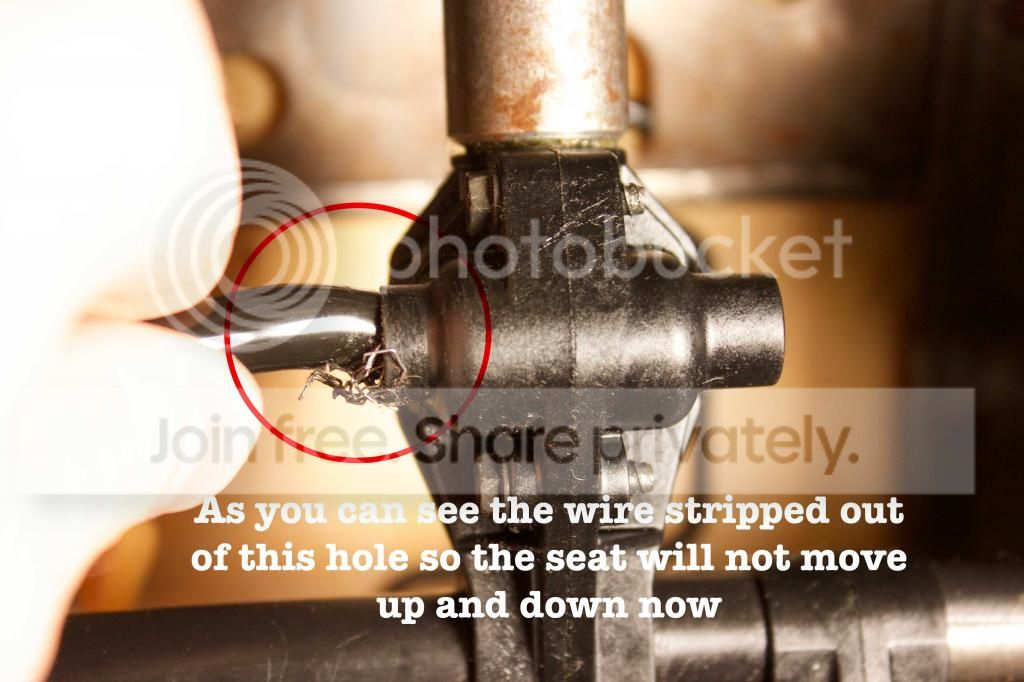

Jun 26, 2014 #1 BlackCDCStang forum member Joined May 14, 2013 Posts 263 Reaction score 0 Location OKC My driver power seat tilt feature stopped working, took out the seat and found this wire/cable destroyed. I need to replace it but i am not quite sure what the part number is or what the name would be? Any suggestions will help.

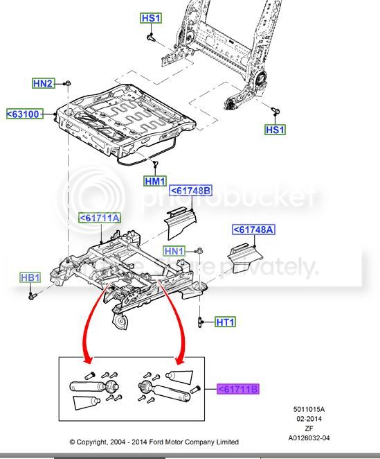

Jun 30, 2014 #2 Steve@Tasca Senior Member Official Vendor Joined Sep 23, 2013 Posts 1,337 Reaction score 54 Judging from the pictures it appears you're going to need a new seat track. Track assy- AR3Z*6361711*A $273.14 plus shipping. There is a seat track repair kit but I don't believe it includes those cables. P/N ER3Z*78617D66*A $39.26 plus shipping. -Steve
